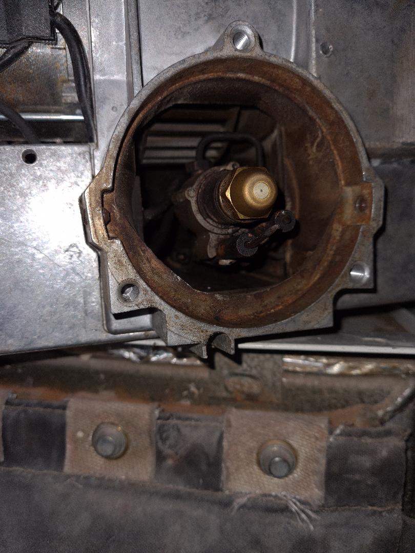

You can just make out the tip of photocell in this photo. The plumber said you can sometimes move the electrode holder thing and there is an allen bolt on the arm that looked like it might move if I loosened it but I put a hairline crack in the cermaic of one of the electodes trying to wiggle it and stopped so that will probably need replacing.
Urghhhh. It still fires sometimes and is no worse at moment from what I can see.
