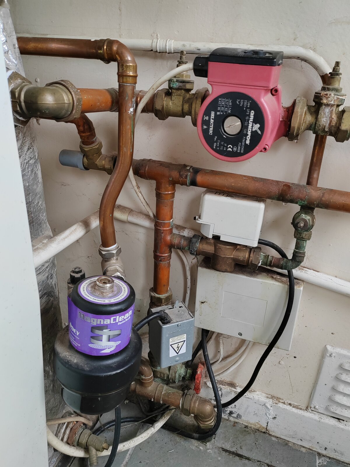

Hi, it's a oil boiler, heats bother water and heating. Approx 10 years old. That's the valve set up in the photo.

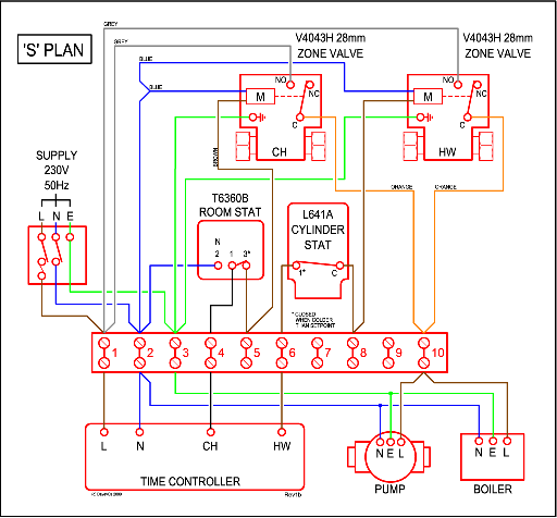

That's a S system so looks like the HW motorized valve is not giving a run signal to the boiler but is opening as you get HW when you request both CH & HW, its probably the micro switch in the valve actuator isn't supplying 230V from the permanently live grey wire to the orange wire, you need a multimeter to check it out.

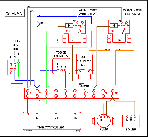

No, not that wire, you should have 5 (certainly 4) wires to that actuator, a earth wire (the 5th one), a brown, blue, grey & orange, the brown wire gets 230V via the programmer and cylinder stat and powers the motor which opens the valve (blue is the neutral from the motor), the actuator contains a set of contacts, one side has a permanent 230V from the grey wire, when the valve opens the contacts close and 230V is then switched via the orange wire to fire the boiler, if the valve is opening (which it is) then you are not getting 230V to fire the boiler, it does fire when you open the CH because this also supplies 230V via its permanent (same) grey wire and its own orange wire. looks like the HW contacts arn't closing, even a phase tester should be enough to carry out a few simple tests.

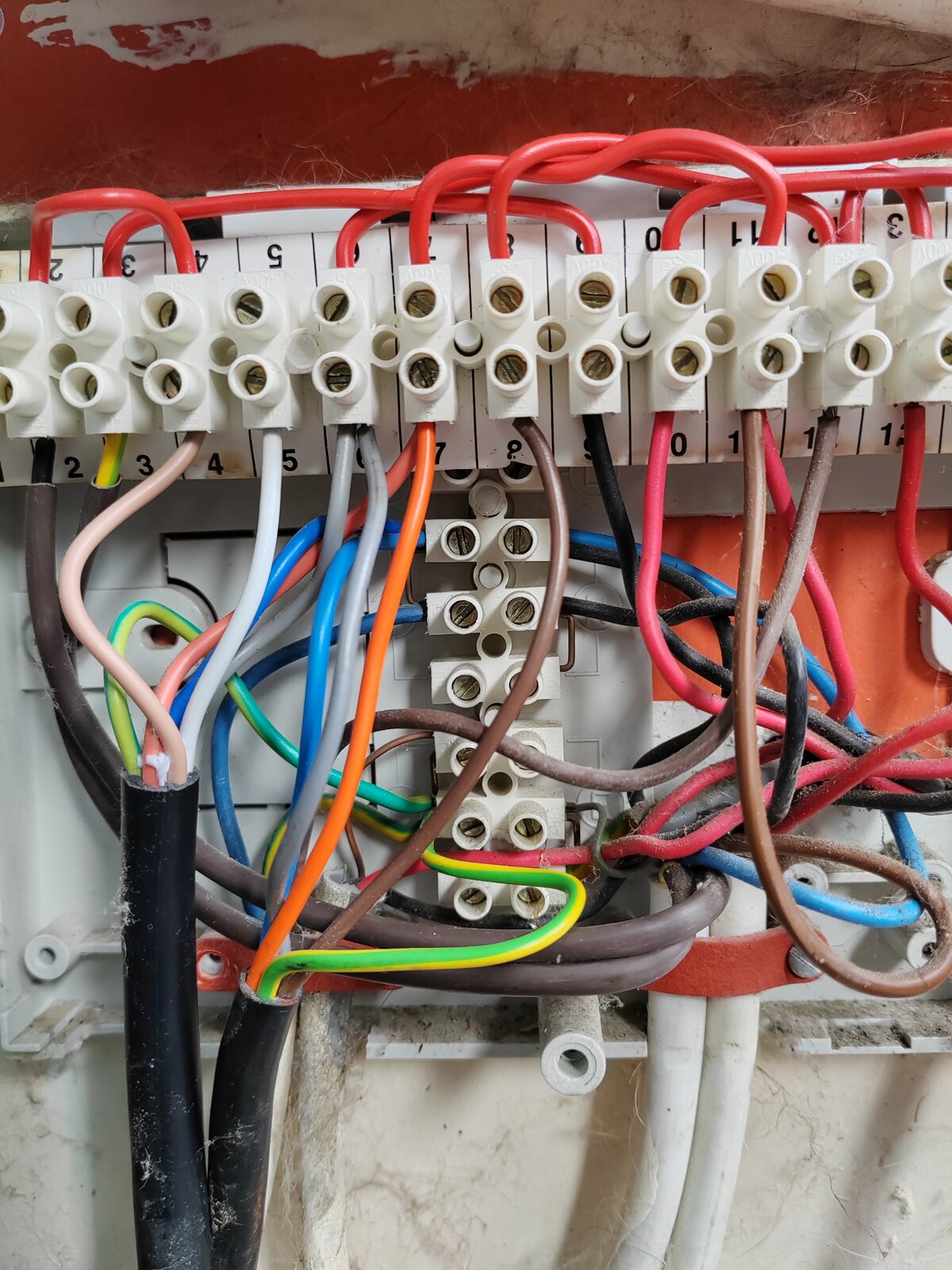

I have attached a photo of the junction box. Both grey, orange, blue and earth go to the same ports.
The brown on the HW wire goes to a separate port as does the CH. In the CH there is a white wire that goes to nothing.
Photo of JB

The new HW cable is the right side black one on the bottom of the photo.
With HW and CH off at programmer, the grey reading is 0, orange is 240.
With HW on at programmer, the grey reading is 0, orange is 240.
With CH on at programmer, the grey is reading 240, orange reading 240.
Whoever wired it seems to have used the orange wires as the permanent supplies to the micro switches and these are then switching the grey(s), shouldnt be a problem IMO, the new HW actuator doesnt seem to be switching the supply to the boiler, seems very unlikely that there is also a problem with this new actuator but its possible that the valve is sticking and preventing the actuator going hard over to close the micro switch. Suggest first, with HW only selected, check for 230V between terminal8 and neutral, this ensures correct valve, next, switch off power, remove actuator with wires still in the terminal block, switch back on the power, select HW only and see does boiler fire up, if not check again for 230V between orange & grey. If it does fire up, shut it down immediately and check that the valve spindle turns freely, it should move with or almost with finger pressure, then get a adjustable spanner or a pliers and move it back and forth firmly up against the open stop, reassemble and test again.
