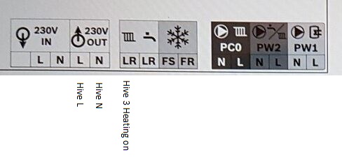

Anyone able to help with a wiring diagram for Worcestor life 8000 and HIVE single channel reciever wiring ? Can`t see anything online.
There are several threads about it on this forum. If you search under 'Greenstar 8000 Hive' you will find them. You can find an example here.

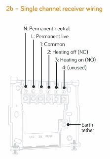

your wiring wont be the same as that as yours is a single channel hive (correctly) that wiring is a duel channel hive so your wiring is different
Ah yes indeed. My apologies, Single Channel Hive it is. There you go:
It will also need a wire link adding to join together Hive terminals L and 1 Common.
If you find it's necessary to open up the boilers sealed combustion chamber to access the wiring terminals then it's not a DIY job, it should be done by an RGI who can make the necessary safety checks afterwards. With some boilers this is the case, with others it's not.
I believe that there may also be different variants of the 8000, a bit like the Ford Focus boilers change over time. So, if your boilers wiring connections are different post back the details.
