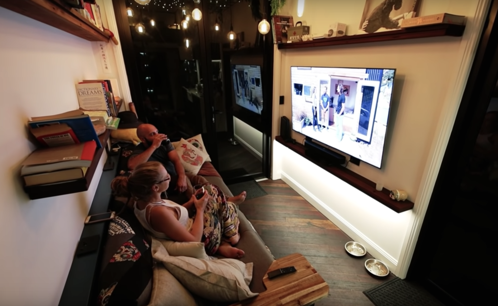

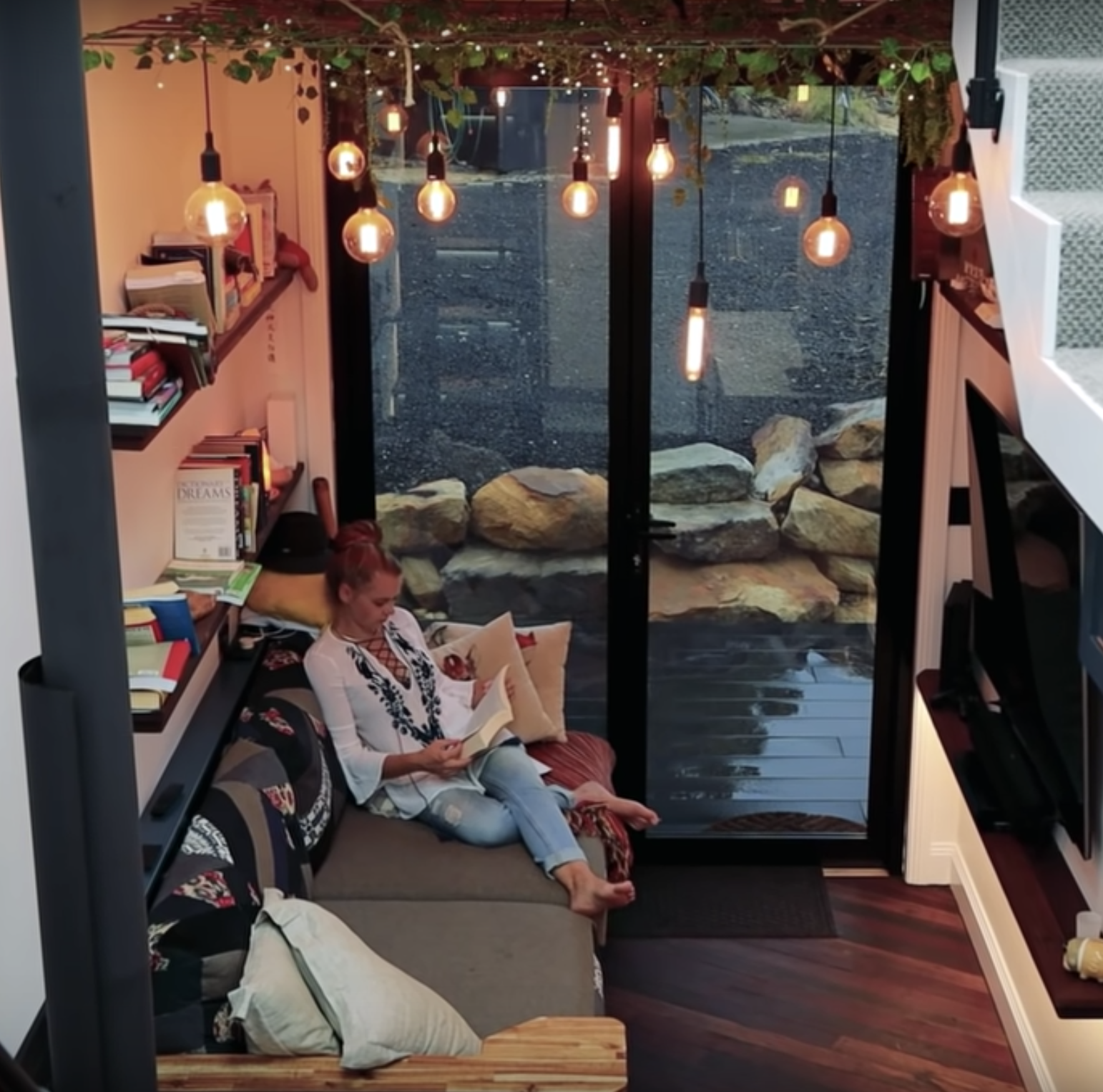

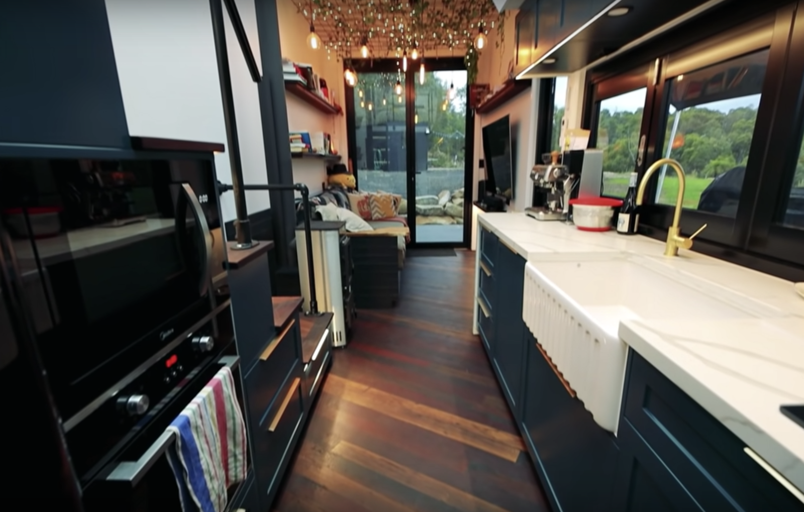

Found a couple who live off grid in the Aussie Bush, they have a modern 'tiny house'.... seems pretty much like it's the same width of this workshop.... looks pretty cool. Seems to work with the TV opposite the sofa. It's pretty much setup like I'd set my concept up. Though they have stairs and a bedroom space upstairs, whereas I'd have everything on one floor.
Taken from:
Yeah, prob will end up being even tighter than I'd hoped. But could do with some official measurements for the width of the plot to confirm.

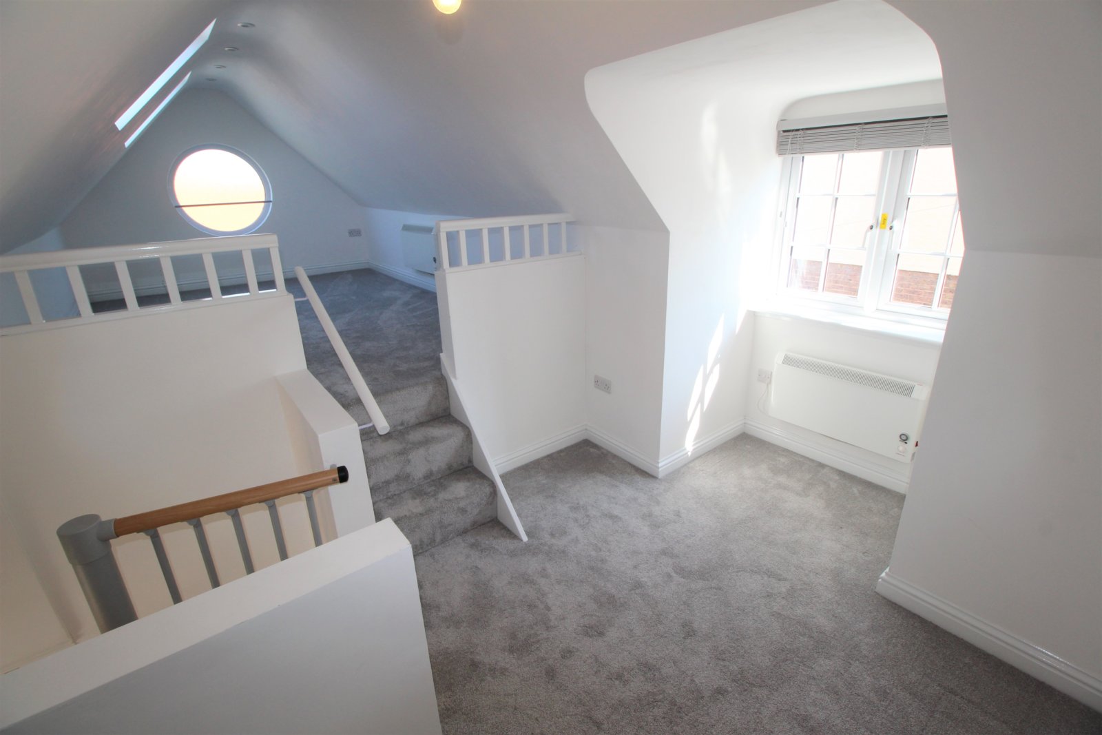

This is the type of thing you get around here at the bottom end of the market. A 1 bedroom house and this is the upstairs. It's cramped. A spiral staircase going up to an awkward space. You could get a double bed in there, but doubt you could walk down either side of it.
You probably only have 2 metres max width of which you can stand up in without smashing your head.
£275,000.

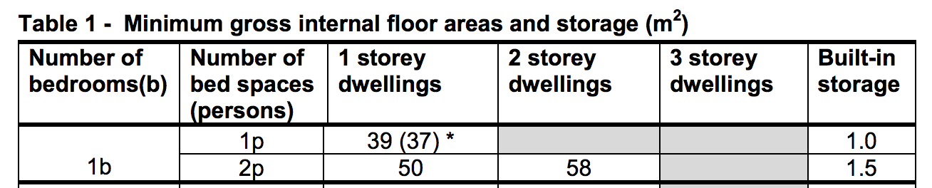

All new residential development must conform to the nationally described space standards as set out by the Ministry of Housing, Communities and Local Government (MHCLG)Technical requirements....
And here they are:
The standard requires that:
a. the dwelling provides at least the gross internal floor area and built-in storage area set out in Table 1 below. NOT SURE WHAT THIS MEANS WITH 'NUMBER OF BED SPACES (PERSONS)'. IT WILL JUST BE ME LIVING THERE. I ASSUME IT DOESN'T MEAN THAT IF FLOOR PACE IS ONLY 39 SQUARE METRES I CAN'T HAVE SOMEONE ELSE STAY OVER, LOL. I ASSUME IT MEANS NUMBER OF SPACES FOR BEDS, AND THEREFORE NUMBER OF BEDS. AS I WILL ONLY HAVE ROOM FOR 1 DOUBLE BED I GUESS I FALL UNDER THE 39 SQUARE METRE REQUIREMENT?
Where a 1b1p has a shower room instead of a bathroom, the floor area may be reduced from 39m2 to 37m2 , as shown bracketed.
b. a dwelling with two or more bedspaces has at least one double (or twin) bedroom. YES. 1 DOUBLE WILL BE PROVIDED.
c. in order to provide one bedspace, a single bedroom has a floor area of at least 7.5m2 and is at least 2.15m wide. N/A NO SINGLE BEDROOMS WILL EXIST.
d. in order to provide two bedspaces, a double (or twin bedroom) has a floor area of at least 11.5m2. e. One double bedroom is at least 2.75m wide.
SO THE HOUSE WOULD NEED TO BE AT LEAST 2.75m WIDE TO HAVE A CHANCE OF APPROVAL, AND IF THE BEDROOM CAN BE 2.75m WIDE, THEN THE LENGTH NEEDS TO BE ~4.3m, THIS INCLUDES WARDROBE SPACE, BUT A WARDROBE SHOULD NOT REDUCE THE WIDTH OF THE ROOM.
f. any area with a headroom of less than 1.5m is not counted within the Gross Internal Area unless used solely for storage (if the area under the stairs is to be used for storage, assume a general floor area of 1m2 within the Gross Internal Area). g. any other area that is used solely for storage and has a headroom of 900- 1500mm (such as under eaves) is counted at 50% of its floor area, and any area lower than 900mm is not counted at all.
ALL GOOD. HEADROOM THROUGHOUT WILL BE AT LEAST 2.3 METRES.
h. a built-in wardrobe counts towards the Gross Internal Area and bedroom floor area requirements, but should not reduce the effective width of the room below the minimum widths set out above. The built-in area in excess of 0.72m2 in a double bedroom and 0.36m2 in a single bedroom counts towards the built-in storage requirement. OK.
i. the minimum floor to ceiling height is 2.3m for at least 75% of the Gross Internal Area.
I DON'T EXPECT THE PROPERTY IS CAPABLE OF BEING 2.75m IN WIDTH, BUT I'M AWAITING THE MEASUREMENTS.
