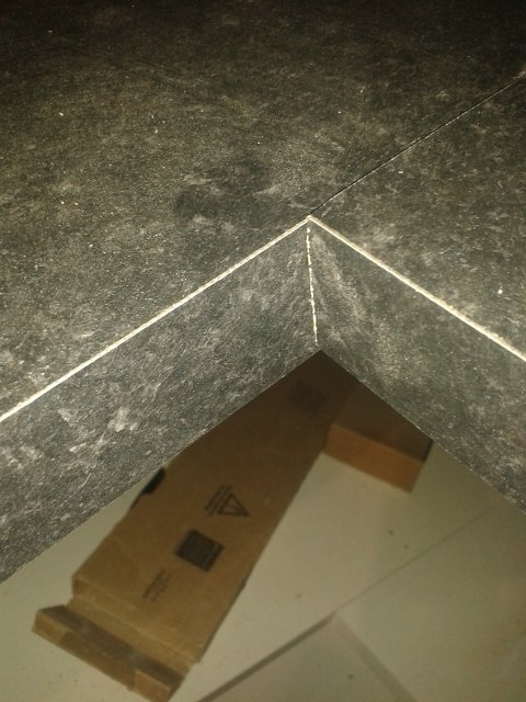

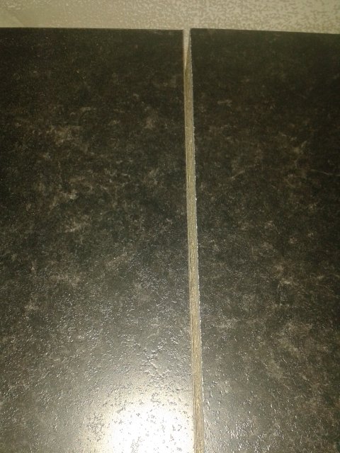

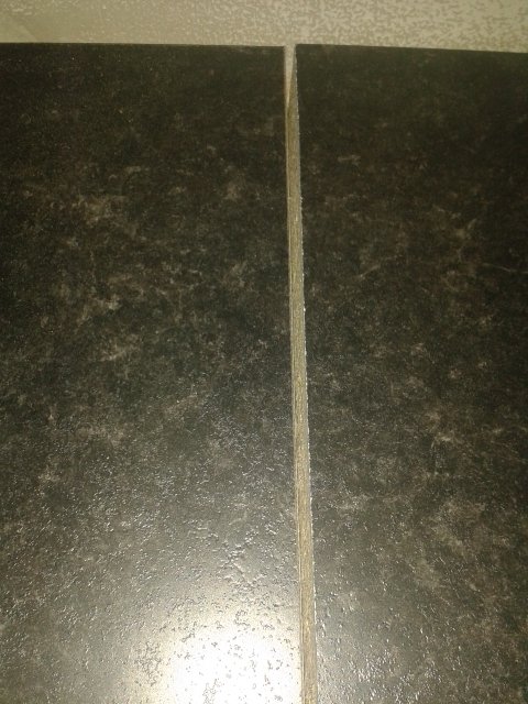

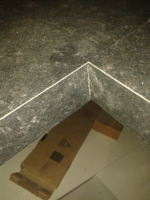

Heres some pics of worktop. Theres small 3mm gap cause units out .

Try this; Go to your local Howdens or Benchmarx or Magnet and ask for the number for a good kitchen fitter ask for a couple of numbers.
Ring said fitter and say you got a butt joint that needs bolting up, but the three bolt holes need routering. You could supply bolts and color fill about £15.00 all in plus labour of £50 or so.
The 3mm as the units don't run square can be lost quite easily with a bit of jiggery pokery with the tops, I presume you tiling or having glass or the like.
A good fitter will router off the laminate edge to the adjoining worktop so you will have a perfect butt joint chipboard to chipboard, not chipboard to laminate.
£150 takes the p*ss quite frankly.
