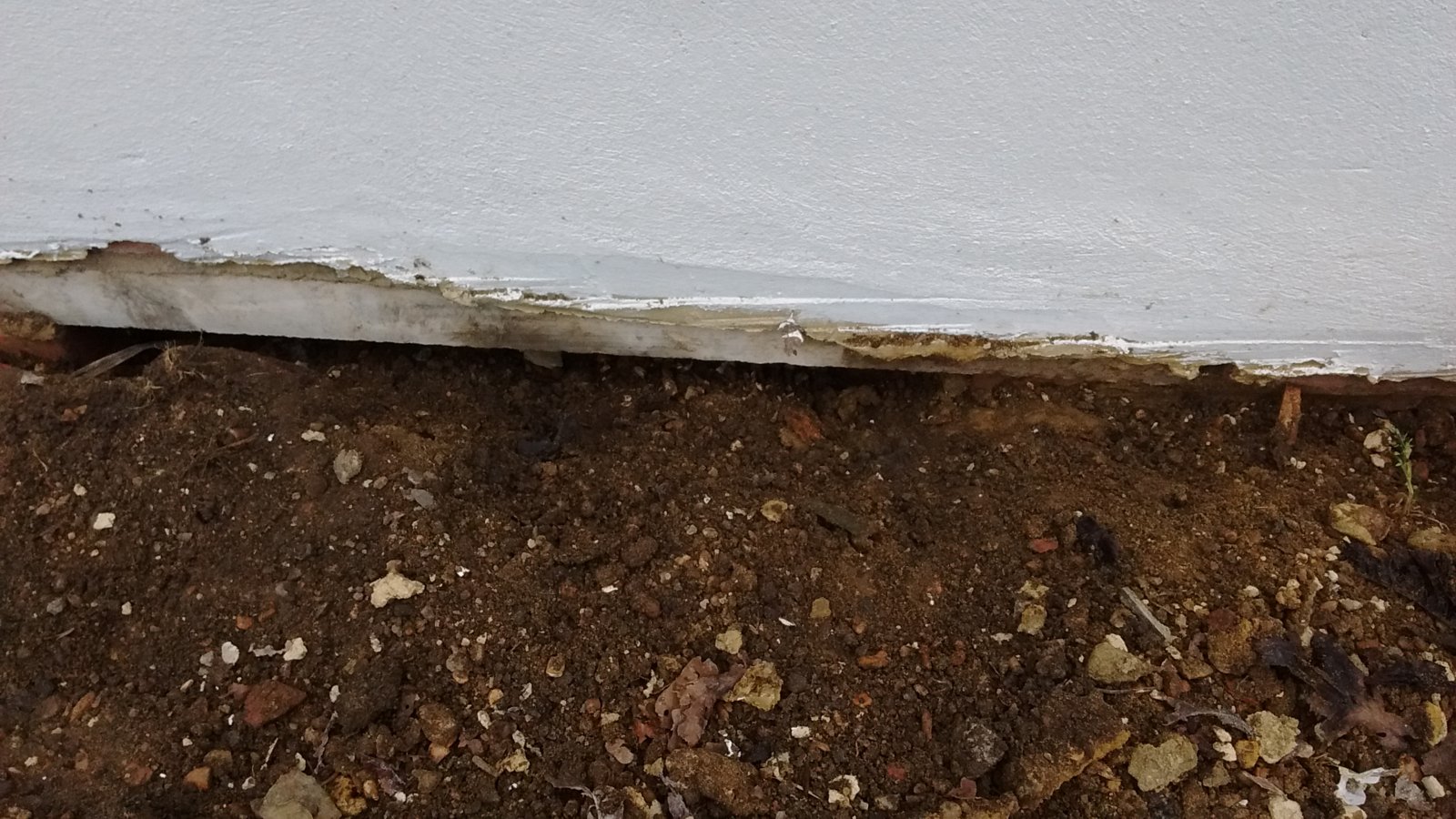

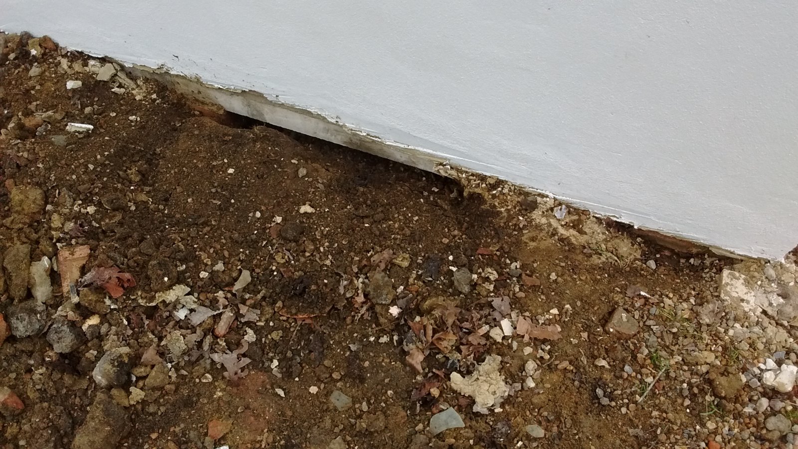

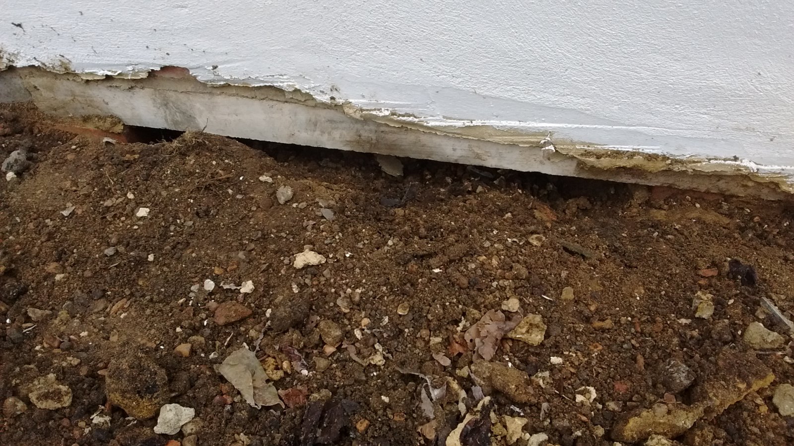

Hi
We have had a small extension built and the builder has not completed the work its a long story but the builder became abusive and threatening so I have told him I don't want him back. We are finding loads of problems with his work and the latest is they left the place in a complete mess and we are just clearing a pile of rubble next to the new build and discovered the footings seem to comprise of a concrete base with small pillars and then lintels with nothing below spanning and taking the weight of the extension. He advised me I didn't need building regs and I am beginning to see why I am concerned there is nothing below these lintels so is this structurally sound as I have two small kids here and wonder now how competent his work is.I have enclosed a photo to show. Many Thanks if someone can advise please.

Im sorry to hear about your troubles.
All extensions need buildings regs, unless it can be described as substantially glazed and seperate from the house.
Its hard to understand, but it sounds like the builder has constructed concret pads every metre or so, then laid lintels to form a ring beam, then built off that.
Im sorry to say it wont be compliant with buildings regs. It also wont be suitable to support the load in a stable fashion. Foundations need to be built in a way that supports the load and sits on stable load bearing ground.
It wont fall down or anything, you might experience a bit of movement causing cracks. Many old houses have almost no foundation.
Do you havevtrees or hedges nearby, what is your soil like...ie sandy, chalky, soggy clay......
Hi Thanks for you reply I have a bit more info I should have said he built a double block building and rendered them The inside blocks seem to be on solid foundations. I saw him mixing and pouring the concrete into the quite deep trench he dug all the way round and he used lintels to span the drains before building the walls but there are no drains on that side so i am not sure why he has used lintels it seems he has built a small brick pillar from the footings he put in and used lintels on this side for some reason but the lintels seem to span as you say about a metre without anything below them which is my concern. We have trees about 10 mtrs away. He did a small job for us and did a good job but then he has turned into a nightmare I have 45 things that need fixing or doing the bloke is aggresive with vile language when we questioned him so I have told him if he comes back again a will call the police I am worried now about the Planning Regs I know this is the builders responsibility but it will cost me. I wonder if I poured concrete under the lintels whether that would help. Anyway many thanks for taking the time to respond to me.

the first thing a competent builder would ask before starting a job (and prob before quoting), is where are the building regs drawings.
how would he know what to build?
In any case, builders that do extensions, know the process and will pretty much know the current regulations -the majority of extensions follow the same basic spec.
every builder will do a trench foundation by default, other options would only be done if required due to ground conditions or some other complication. In general, a trench is dug about either 340mm wide or 600mm wide about a metre deep, and around 600mm or so depth of concrete poured in. Then both skins of masonry are built off that.
If you have a construction that varies from that, the builder would needed to have followed an engineers spec.
if the extension is open to the house, is heated and has a solid roof -it needs building regs and therefore each stage should have had inspections to be signed off at the end.
