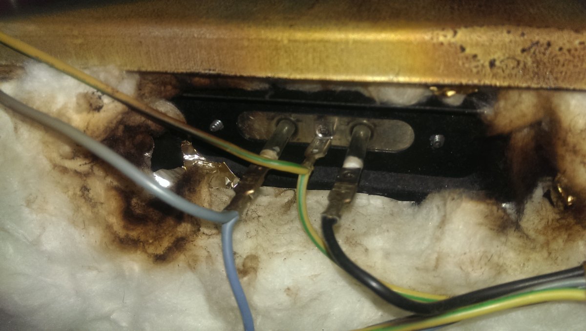

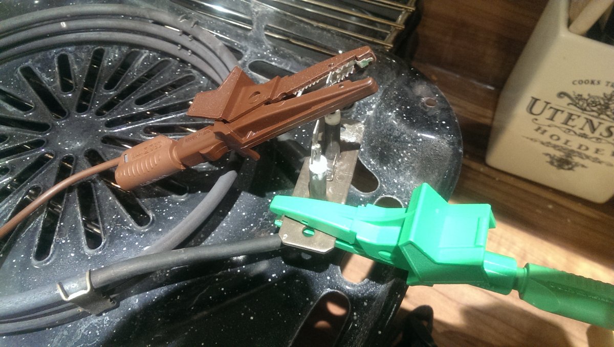

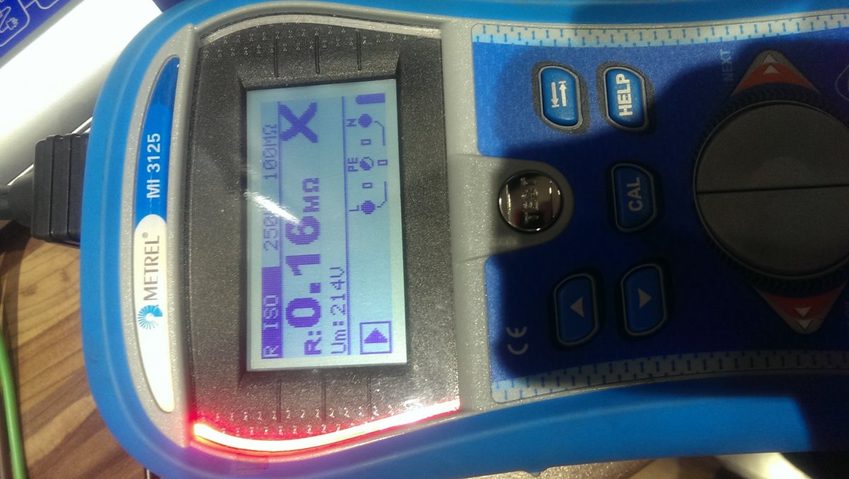

My oven decided to give up and the fan oven heating element has failed (IR: 0.16-0.29MΩ @250v).

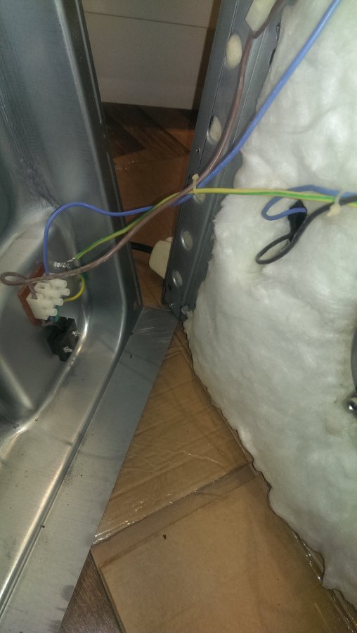

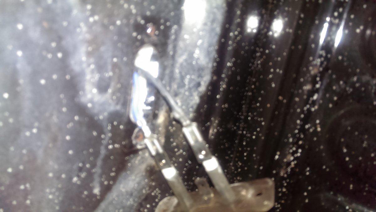

While taking it apart to test I notice this element had an earth terminal but no earth connection, I decided to test the grill element while I was at it (all ok) but noticed this element is earthed. I assumed the earth tag might of fallen off and was in the back, but no sign of this element ever being earthed (apart from being connected to the chassis)
Do you think it would be wise while I'm replacing the element to put on an spade to earth, I cant see why it would cause any issues or be designed not to have an earth. I assume it was either missed in production or the factory just cut some corners.

Yeah, I would much rather it be earthed directly to the element rather than relying on the screws making some attempt of earth. But thought I would double check just in case there could be a remote chance of this not being earth for good reason (apart from cost/time cutting).
If there were any potential problem (goodness only knows what!!) with it being earthed then, as you imply, there would already be a danger, since it's going to be earthed via the plate and fixing screws, anyway - so to add the 'proper earth' (which undoubtedly should be there) can't possibly do any harm.
Kind Regards, John
I worked repairing appliances for a few years, it is very common for cooker elements to have no wired connection to the earth terminal.
Yes, even I have often see that - but in the OP's case, it seems a bit odd that there is a wired to to some, but not all, of the elements.
Kind Regards, John
Perhaps wired to the exposed to touch ones, but not the ones behind covers?
yeah that's what I originally thought, but just still seems like they could of just gone that little bit extra to add one more earth connection. Anyway hopefully I'll be able to pickup a suitable element for a fair price so save me getting a new oven and I'll sort out that earth connection to it.
Thanks for all the feedback.
Personally speaking, I agree ("if it's worth earthing, it's worth earthing properly" :) ).
Kind Regards, John
no matter what anyone says, all elements should be earthed properly by its own terminal, cannot rely on screws fixing element into the chassis of the oven, can give high resistance joint.
Yeah definitely agree with that, I did a few resistance tests with varying results. Doesn't help when the oven is coated with enamel (or whatever is it) so the screws have very little bare metal to make contact with.
