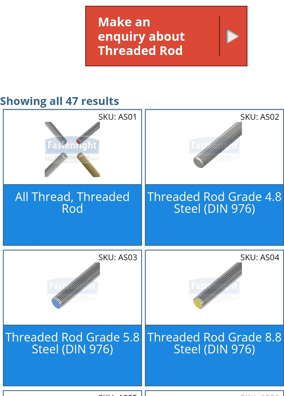

The two most common grades of bolts are 4.6 and 8.8 (not sure if there's a 5.8?) 8.8 is usually used for steelwork, and 4.6 for timber work.
I don't know if it's because we do a fair bit of machining, rather than building works, but grade 4.8 and 5.8 threaded rod (not bolts) are pretty standard for us....
