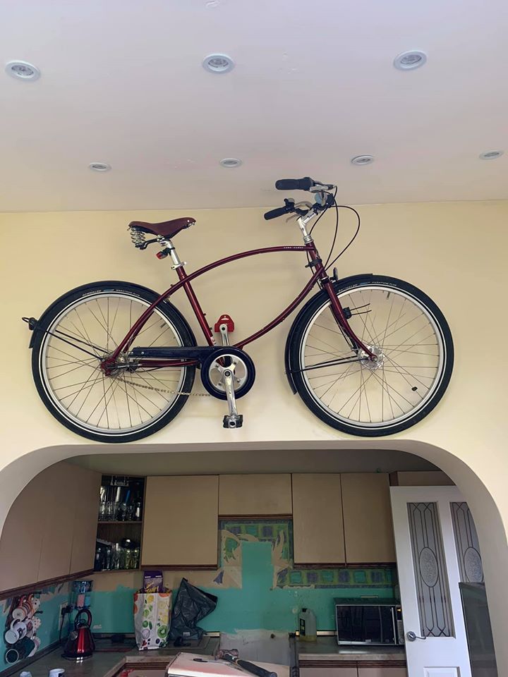

So my old house now my sons, he to my mind went mad with down lights 98361719_10158572386853420_1054327038518755328_o.jpg but he has had many fail, so question is if due to poor quality, or spikes?

I am not saying these bulb failures are due to surges or spikes, the question is why did I not also loose living rooms and dinning room lights, 16 bulbs in all, after going LED the many failures with the Philips 8 watt CFL was a thing of the past, but could those Philips lights failed due to spikes?
The answer is no one knows, fact that the cheaper golf ball lamps from Home Bargains did not fail points to the expensive Philips lamps being low quality, but who knows?
