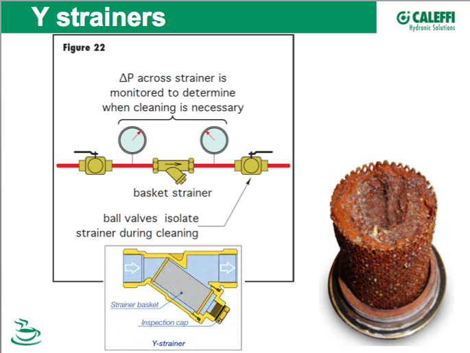

Hoping to open up a technical discussion regarding best practice with Y-strainers (also spelled wye – strainer) on domestic CH systems.
I’m hoping this thread can be a general discussion to explore this topic & share any insights members might have. I’d like to flesh this out - so newbies can enlighten themselves too.
(Assume the Y-strainer is fitted in addition to a mag CH system filter).
Stating the obvious - Two types of debris in CH water - magnetic & non-mag.
Magnetic system filters generally deal with the mag debris VERY well e.g magnaclean, spirovent etc. However - this is not always the case for non-magnetic particles

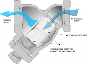

This is where Y-strainers can help. Essentially it's a sieve that collects muck - using a simple stainless steel gauze. They can be placed inline on both the, coldwater fill and/or CH return loop:
Credits: i) Choosing the Right Straining Element, Part One - The Pipeline Flow
ii) Caleffi Hydronic Solutions
Important:

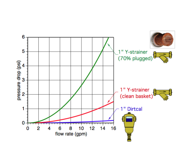

1) They cause a pressure drop in the loop - so step up one/two sizes to increase the surface area of the gauze.
2) They need to be isolated - before & after the valve - so that the gauze can be extracted & cleaned (frequency depends on how dirty the water is).
3) The only real way, to be able to see when it’s blocked – is to have pressure gauges installed inline too - to assess the change in pressure across the gauze/strainer.
Any contributions regarding the basic primer above, is most welcome.

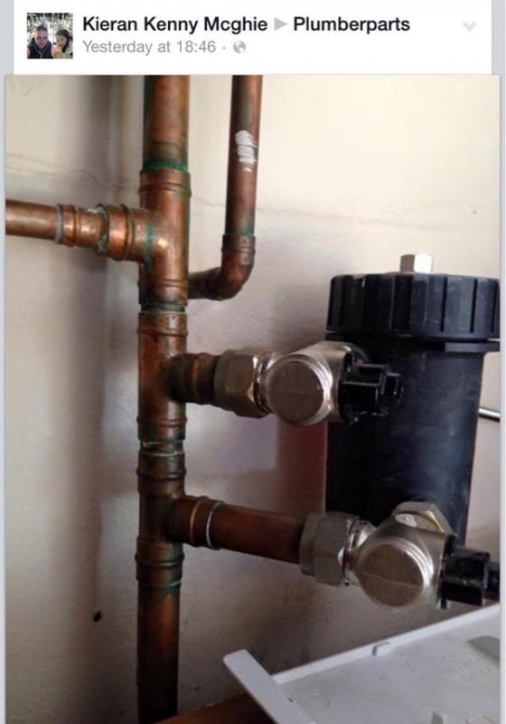

and two interesting filter installs:):) one is a magna leak and the ceiling one is the dire original fernox F1 filter
