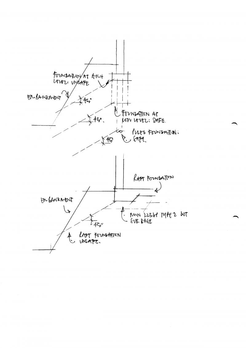

can anyone please tell me where i can find some information, drawings ect of raft foundations
we are proposing to build a two story extension, the land we are building on is virtually all sand below 1 foot of digging
our site is next to a railway line and railtrack are concerned that our building will collapse down there embankment and want a cat 2 design certificate?
any help would be most grateful
thanks
If they are concerned about the stability of their embankment, a raft won't help: either deep(er) foundations or piling are required.
A quick scribble in explanation:
There may also be slip circles to consider, which are dependent on the types of soil under your land and that of the railway.
indeed in the event of a landslip your raft could become just that a raft surfing away on a wave of mud and sand.
