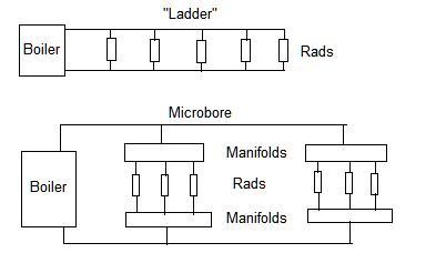

Balancing of microbore systems will always be tricky as the radiators are not in parallel, like the rungs on a ladder. This pic shows the difference -
Assuming you have a two storey house, you will probably have one pair of manifolds for the ground floor rads and a second pair for the first floor rads. The pipes from boiler to manifold will probably be in 22mm; only the pipes from manifold to rads will be 8mm or 10mm.
All the rads fed from one pair of manifolds will heat up almost instantaneously, though the smaller rads will tend to heat up quicker. Adjusting the LS valve alters the flow rate through the radiator. The flow rate is directly proportional to the radiator output (flow for a 2kW is twice that for a 1kW). But this does no mean the LS valve has to be open twice as much, due to the design of the typical LS valve.
Try adjusting the rads in size order - largest first - and have the LS open as little as possible to give the required differential. You will have to adjust the LS by an eighth of a turn or less at a time and leave sufficient time for the temperatures to stabilize.
