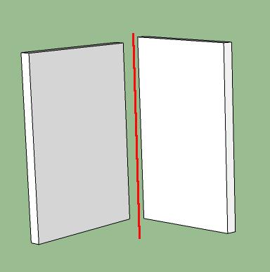

Can somebody please give me some advice.
I have 2 doors that require architrave - the architrave is 44mm chamfered (to match existsing woodwork). The doors meet in the corner of a room (indicated by the red line) door no.1 (left in picture) has a distance of ~30mm to the corner and door no.2 (right in picture) has a distance of ~20mm to the corner.
Therefore i need to cut two long lenths of architrave down by 14mm and 24mm effectively narrowing the wood and neatly join these in the room corner.
How would i go about making the cuts ????
Is it best to just but the two architraves togethor or do i need to cut a 45 mitre slope along the leading edges.
I only own a B&D workbench so am at a loss as to how i can accurately cut such a thin strip? - would a wood yard trim this for me? I have asked at my local B&Q and there cutting machine requires a minimum of 8inches width.
What tools / techniques can i use/employ to cut such a long fiddly strip - i was "guessing" maybe a jigsaw with the blade at 45degrees may work but i can only imagine how inaccurate that would be ..arghhhh
Thanks in advance for any advice
Ps. I am using MDF - so will there be any issues using wood filler should i make a mess of the cutting.
I would butt them together, you generally don't mitre internal corners as they always pull apart, are mostly never true 90 degrees and just too damn fiddly, do your corner mitres first though then trim the width down and after you can if you so wish just run a small bead of decorators caulk down the corner and finger it in to get a nice jointless joint :wink:

Personally, I'd just run a bit of quadrant up the corner and scribe the architrave across the top of the frame to it. With the distances you have mentioned from the door frames into the corner, it's hardly worth messing about with bits of architrave. :wink: :wink:
or just resort to the good old fashioned hand saw then run a block plane down it
cut the arcs to the widest width[5mm set back and 23mm cut 2mm gap
get some quad or moulding to give you a 5mm setbackand reach the arc you have just fitted
eddit as you arcs will be around 15mm just leave the 20mm side as it will only be showing 5mm anyway

Do you mean .. cut the wood roughly to fit in the corner and then hide the crap join with beading - like this ....
sorry the 2mm gap was because the other arcatrave would cover but it wont be there :lol:
you need to scribe to the wall then as the arcatrave will be around 15mm thick it wont leave any room for anything on the other wall
to be honet joiner johns answer will be by far the easiest as long as the heads[top off the frames ]line up in the corner

I have the same issue as above where 2 door architraves meet in a corner and I need to trim one or both.
I am happy making a good cut down the length of the architrave but how do i make the mitre with the top piece? A 45deg mitre will not work with 2 different widths.
Do i just alter the angle of mitre?
It does work, but each header architrave has to have the end where it meets the narrow piece cut off squarely, by the amount that you are reducing the upright piece by. No matter how you try, they will not meet at a point in the top corner unless you have plain timber and alter the angles, which will look odd.
The simplest way to do this is to cut your header at 45°, then from the lowest point of that mitre, mark the width of the reduced upright. You will then see where the top corner of the header piece needs to be nipped off. Because you are not working with the full width, when you mitre the upright, it will be a little shorter overall than the other side.
