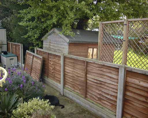

Does anyone have any suggestions how I can replace 4ft fance panels with 5ft panels without it looking stupid. I want a taller fence but don't want to replace all the concrete posts. I think it may look a bit odd with the panels a foot taller than the posts. Any ideas?
personaly i dont think it will work for two reasons one the strength of the panels may be compromised if you cant secure the extensions firmly[flexing that could break the pannels]
also the post needs to be deeper in the ground to support the larger pannels when the wind gets up
could you not just secure a batton to the post with cable ties attach trellis to the top

I have just done mine last week from 4' panel to 6' panel with ex-concrete post by building round it. I even surpised myself and it's very strong.
Will take a photo tomorrow to give you some idea, too dark to take picture now!

Funny enough the sun never on these fence panels because of my neighbour trees so it shouldn't dis-colour plus they are forest pine fence panel with a 15 years guarantee against rot but I will treat it in the future as you says I have seen them going a strange colour.

We used to look after a nice elderly lady (now passed away) and she wanted a low fence to keep her happy, then new neighbour arrived thus a higher fence without being too unsociable and talk though the trellis !

They are only there so I can go to my workshop when it's dark without tripping over ;)
Thanks for the photos it really does look impressive and has given me some ideas on how to address my little problem. thanks again.
I use forest pine fence panel ( not cheap but you get what you pay for ) the panel are 1.8m and not 6' panel, many people has been caught out if you're sliding it into ex-concrete post. So what I did is made a 1/2" batten screw to the both sides of the fence panel so this will hold it in position in the post, then use 140mm floor decking with a small square batten with screw to the decking on each side so you now have a low U shape then with a longer screw to screw it into the fence panel so this will cover the concrete post. The forest pine fence panel is ideal for this being small in length which make it easier to screw the decking onto it. Will need to make a bigger cap on top of the post. I have use a dpc on top of the post then use a forest pine cap post.
