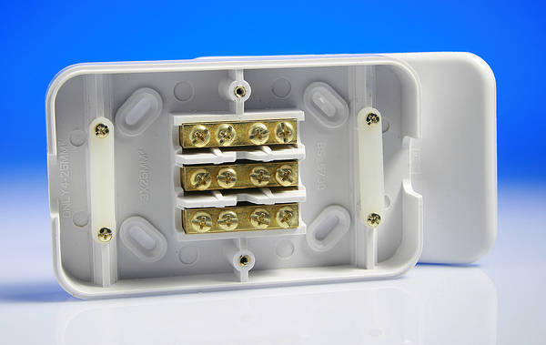

You can get 60A JBs - e.g. this:
(I would say "other products are available", if I knew of any...)
As it's rated at 60A, it probably will take 10mm cable. You can check with TLC, but I doubt if it will take 2 x 10mm in the same side.
