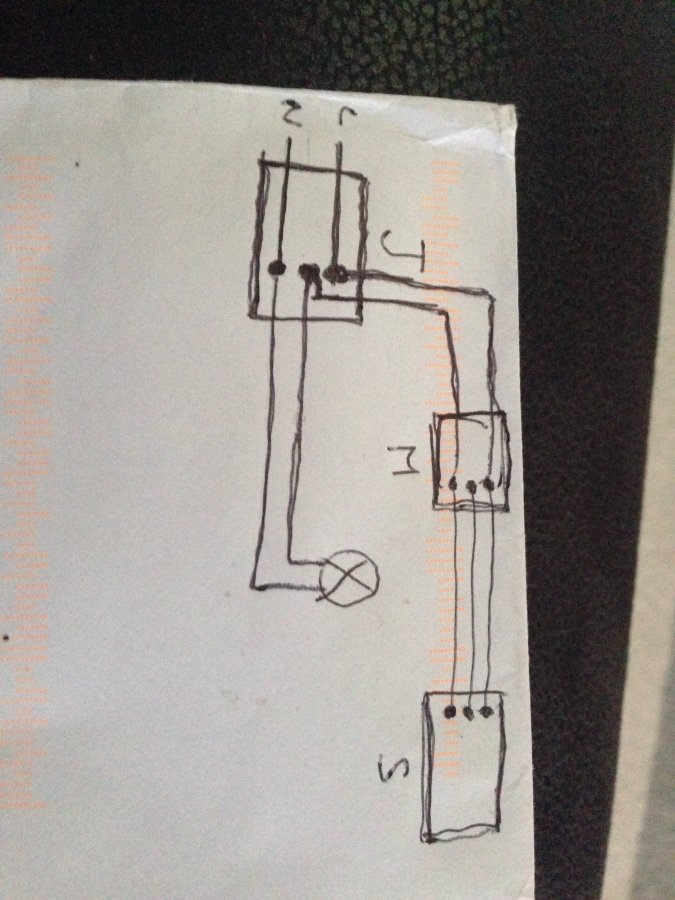

If a conductor is continuous and connected to both switches it doesn't matter where (along that conductor) you connect the live or load.
Not a very good drawing but this is what am planning :)
Fair enough mate you can put power in the slave and take it to master but that would mea the load would have to come back upto the light from the master so I would have to run a double up for that anyhow so may aswell send down a 3 core from the slave to master and a 2 core for the split live :/ confusing myself now lol
Yes you can connect the live at any point to the L on a master or a slave but (and this has been said a few times before) it must be an L from the same circuit as the N.

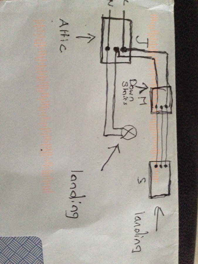

Does anyone have a better idea than this circuit/situation ? Any input would be appreciated ?

I think you are still missing the point.
On your latest drawing, transpose 'M downstairs' and 'S landing' and it will be easier to wire.

Yes, I know, so connect the L and SL to the slave at the landing.
The master and salve are connected with a 3 core like the Varilight circuit drawing says live, load and link all connected one 3 core cable ? :/
