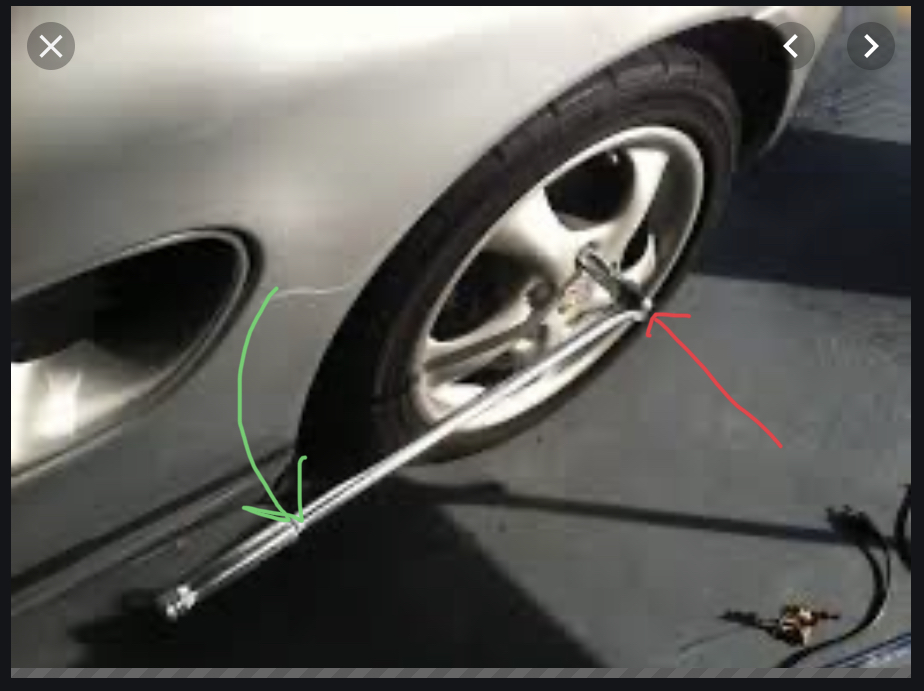

In the past, to loosen a very tight wheel bolt, I’ve held the pressure on the bolt with a breaker bar while someone strikes the end of the breaker bar directly onto the nut/bolt with a big ‘ammer!
Hold pressure on in direction of green arrow, strike bar in direction of red arrow.
If I was undoing the nut in the picture, I'd turn the steering a wee bit to the left. That keeps the breaker bar away from the bodywork and gives you more room to move. Also, that breaker bar appears to be have a short extension on it, in which case I would try to support it near the wheel. I like to keep the distance between the bar and the wheel as short as possible.
