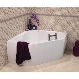

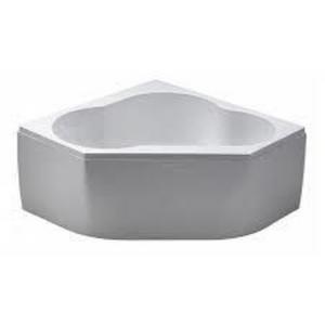

    Anyone fitted a Realm Corner Bath from Victoria Plumb??
    It MAY have a baseboard buried within the fibreglass. It does have 2 horizontal supports that screw into the base which is when I realised there doesn't 'appear' to be a baseboard to screw into. And screwing into just fibreglass is pointless.
    What constitutes a good quality bath though? Having a baseboard? Thet come across as a decent company. Reason i ask about the baseboard is because the bars that have the feet attached screw into the base of the bath. So i dont want the screws to protrude the bath. Ha As for supporting...
    Hi all, Have bought and had delivered a realm corner bath from Victoria Plumb. Anyone familiar with it or have first hand experience fitting it? First attempt by competent DIYer but any helpful tips would be appreciated! Firstly, the base of the bath has no wood panel attached to...
