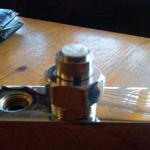

    Leaking Shower Valve
    No, there are no rubber washers provided other than a filter with a rubber sorround. I've spoken to Bristan Technical and they say no further seals are required, not even PTFE on the threads! Tried a couple of combinations on PTFE across the the fixing bridge into the valve but still leaks. I...
  7. I
    Speedfit and Olives
    From the wall the 15mm push fit is going into the valve via wall mount onto which a shroud is screwed, the valve has 22mm nut which screws onto the shroud and this doesn't appear to be a compression type joint. The only other item between the end of the pipe and then into the valve is filter...
    Currently in the process of fitting a Bristan Quadrato Exposed Fixed Head Bar Shower with Diverter and having a little trouble with one of the inlet's to the valve leaking. I'm using 15mm Speedfit with inserts, have PTFE'd the threads of the mount fitting. The fitting instructions are not...

  12. I
    Speedfit and Olives
    Speedfit is come through a brass mounting fix on the wall going into a chrome plated brass threaded valve inlet with nut going onto the wall outlet - suspect that PTFE over the threads of the wall mount will do the job and not use the Olive

  15. I
    Speedfit and Olives
    About to connect up a shower in to 15mm speedfit pipes. Do I need to use the 15mm copper olives that came with the shower fixing kit or will the 15mm pipe inserts suffice?
