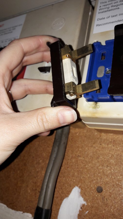

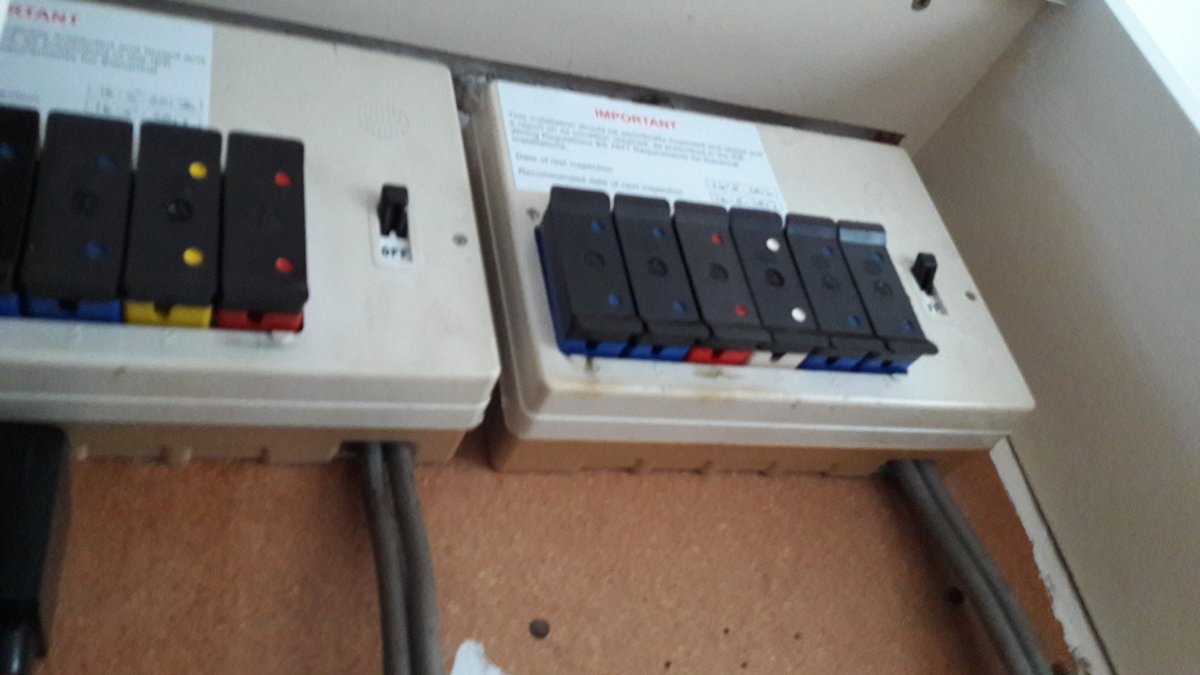

We have an old house, 1900's. It has an old style fuse box, 2 of them, kind of 2 pin plugs that plug into it with a wire going through the middle. Yesterday, went to turn the upstairs light on and nothing. We then found that ALL the upstairs lights have gone plus 2 downstairs, sockets all still work luckily so we have lamps. None of the wires have snapped, some you can see have in the past but all currently in tact. Obviously tried turning on and off, any idea's? We are complete novices so no fancy electrical talk!

Are you saying the wire in the fuse hasn't broken? Are you sure? Could be something as simple as a bulb blowing and taking out the fuse.
With the old Wilex fuses you have it is easy to strain the fuse wire when tightening it up, so it looks good in centre but has failed at the end.
If following the rules, because the maximum fuse for a ceiling rose is 5 amp, even though you are allowed 16 amp for lighting in general, it is normally 5 amps for lights. You show looking at a 15 amp fuse (blue) not a 5 amp (white) so have you looked at the right fuse.

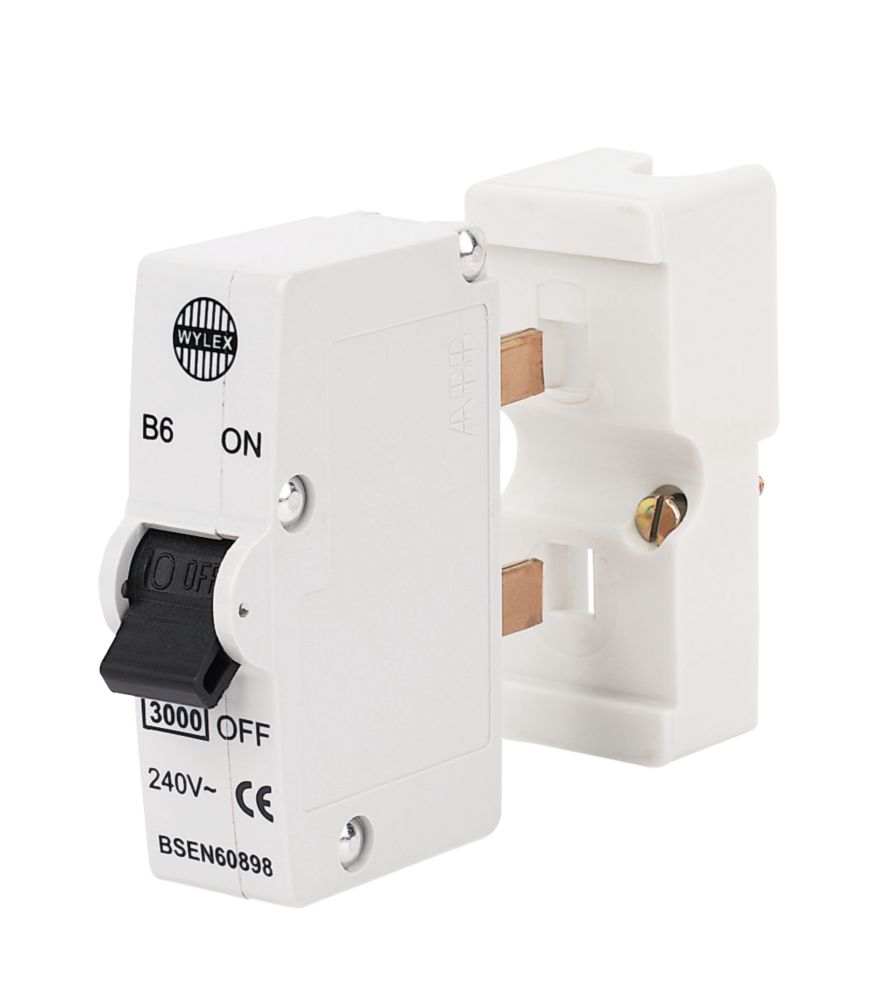

That fuse box has had 3 upgrades, first they introduced a cartridge fuse, then a trip with button, and then trip with switch, they are easy to fit, however the circuits should be tested before the up-grade.
So turning off the main isolator because behind the base there are live buzz bars you can fit one of these
ae235
[/img]as I have said really should be tested first so I would only renew the faulty one to start with there is also the 16 amp version however today the fuse box is no longer used, we use a type tested distribution unit called a consumer unit, these now have extra safety features called the RCD, to replace all the fuses with MCB would cost you over £120 which would go a long way towards fitting a new consumer unit. Renewing one at £10.06 where you have the problem may be a way around lack of fuse wire, keep you going until you can get an electrician, but I would not swap the lot as they will be scrap when consumer unit changed.

All upstairs and 2 individual downstairs lights sounds like one circuit. So one of the fuses is the likely problem.
If you don't know which is which, a bit of trial and error (removing one at a time and seeing which circuit stops working) will identify the one that is faulty as this will have no further effect, when removed.
Switch off the main switch at each removal/replacement.
As said, the fuse wire may "look OK" in the centre, but can be broken. They can be tested with a multimeter, but its so easy to replace the fuse wire.
As to this rubbish about not being able to obtain fuse wire!!!!!!!---ask your dad, grandad or any householder who looks as though they have a bus pass or try a local market hardware stall.
Call electrician since tracing problem will require skills that you state you do not have

Do you still have the fusebox covers, inside is usually written what the circuits are.
