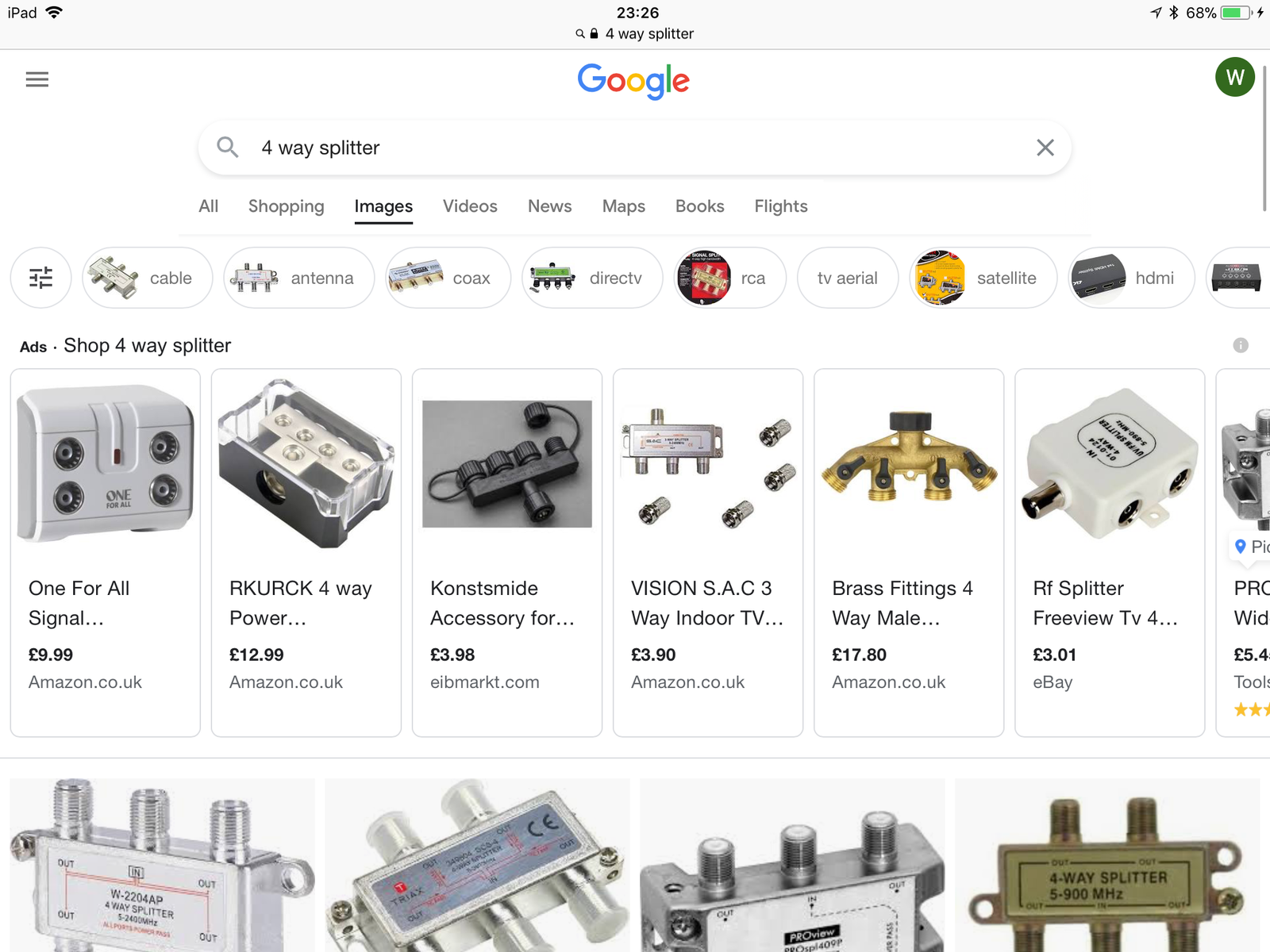

I have googled 4 way splitter as requested. How should I connect 3 heaters to any of these?
Extension lead maybe?
Just a wild guess, or maybe it's a technical electric device.
