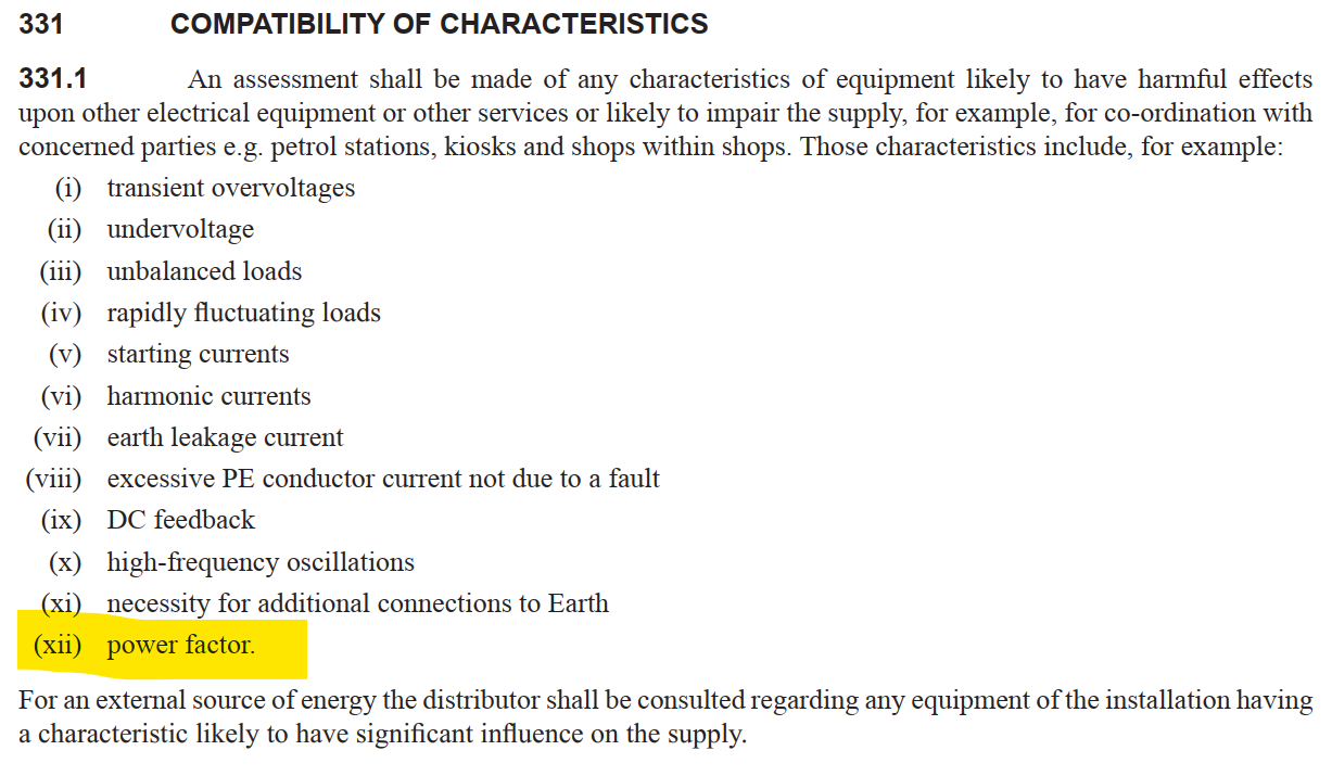

Does this not cover it?

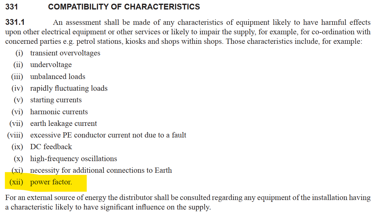

Yes, I understand that power factor is a factor to take into account, but the exam question clearly expects the student to know that discharge lighting needs a 1.8 factor for breaker current selection, without stating a value for power factor.
There doesn't seem to be an obvious regulation in BS7617 for this and it's not taught in the 8202 course, so I just wondered where this factor came from.
It's clearly a bit of 'rule of thumb' sparky folklore that everyone just knows, but it sucks as an exam question! Mind you, C&G are good at those type of questions...

Why would the power factor be in the regulations?
Surely that would be like designing a shower circuit and expecting the power of your shower to be in the regulations.
