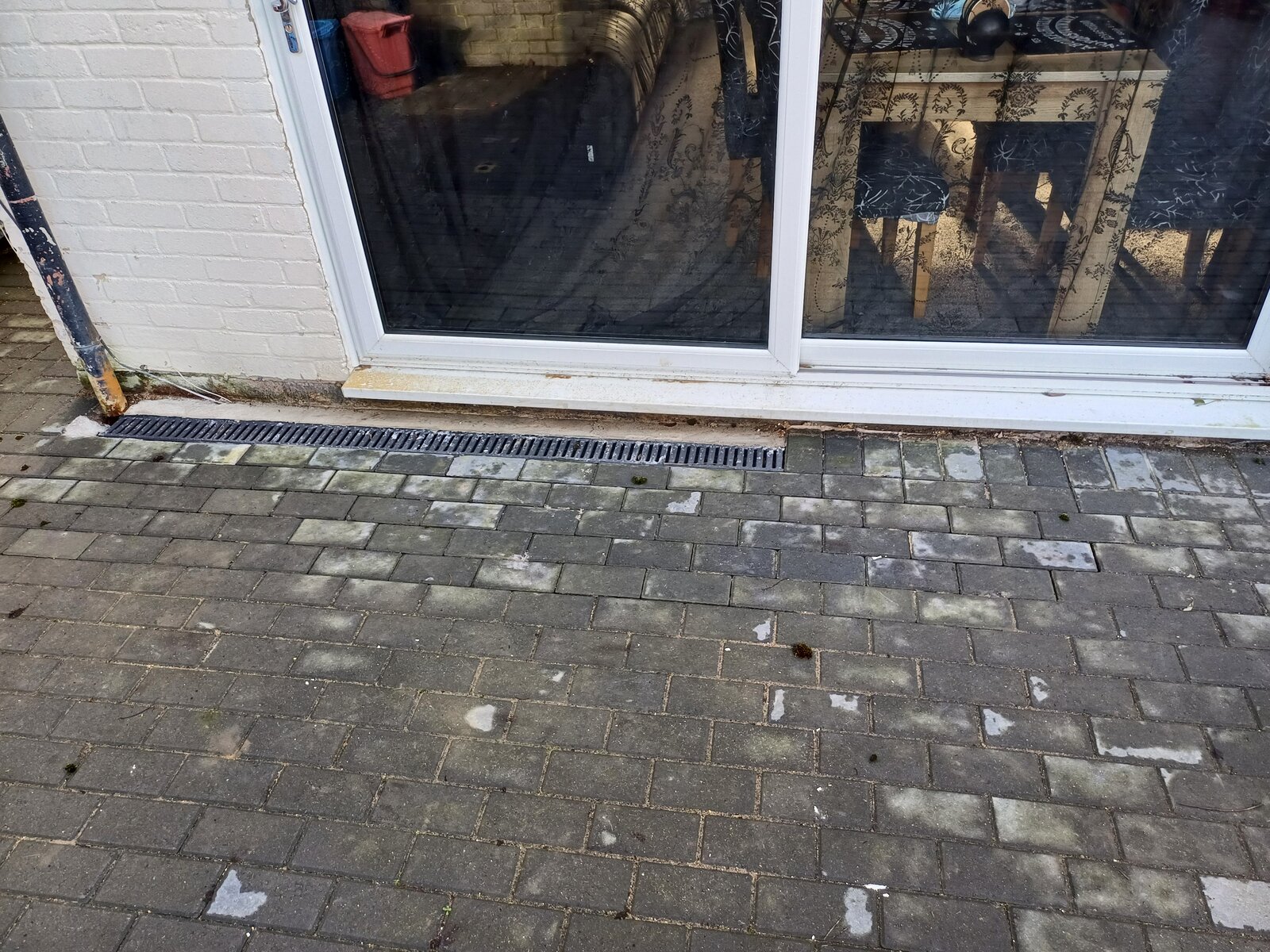

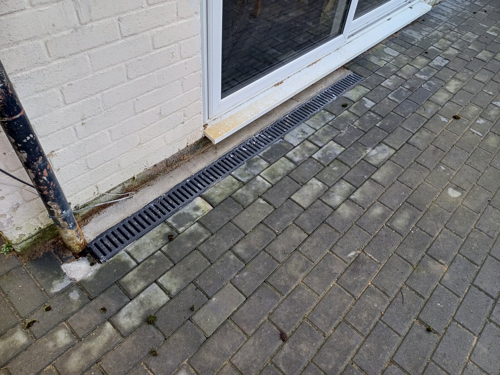

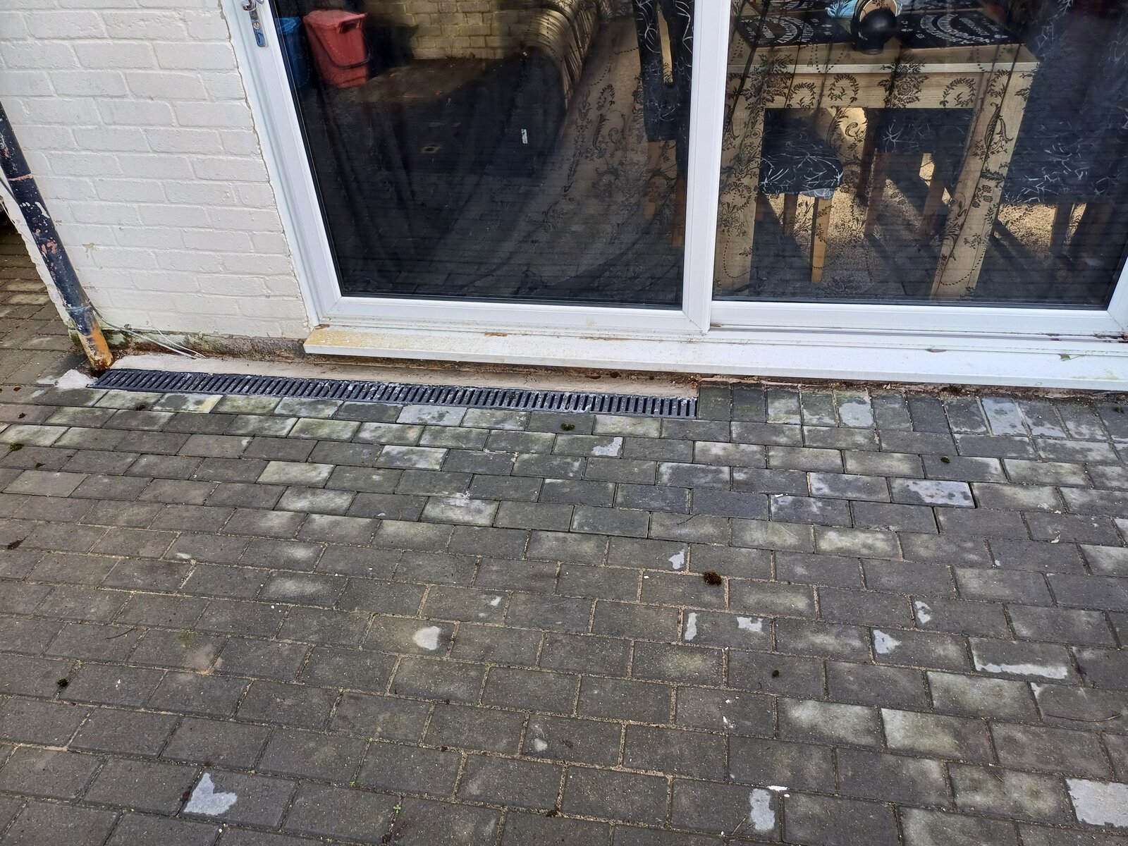

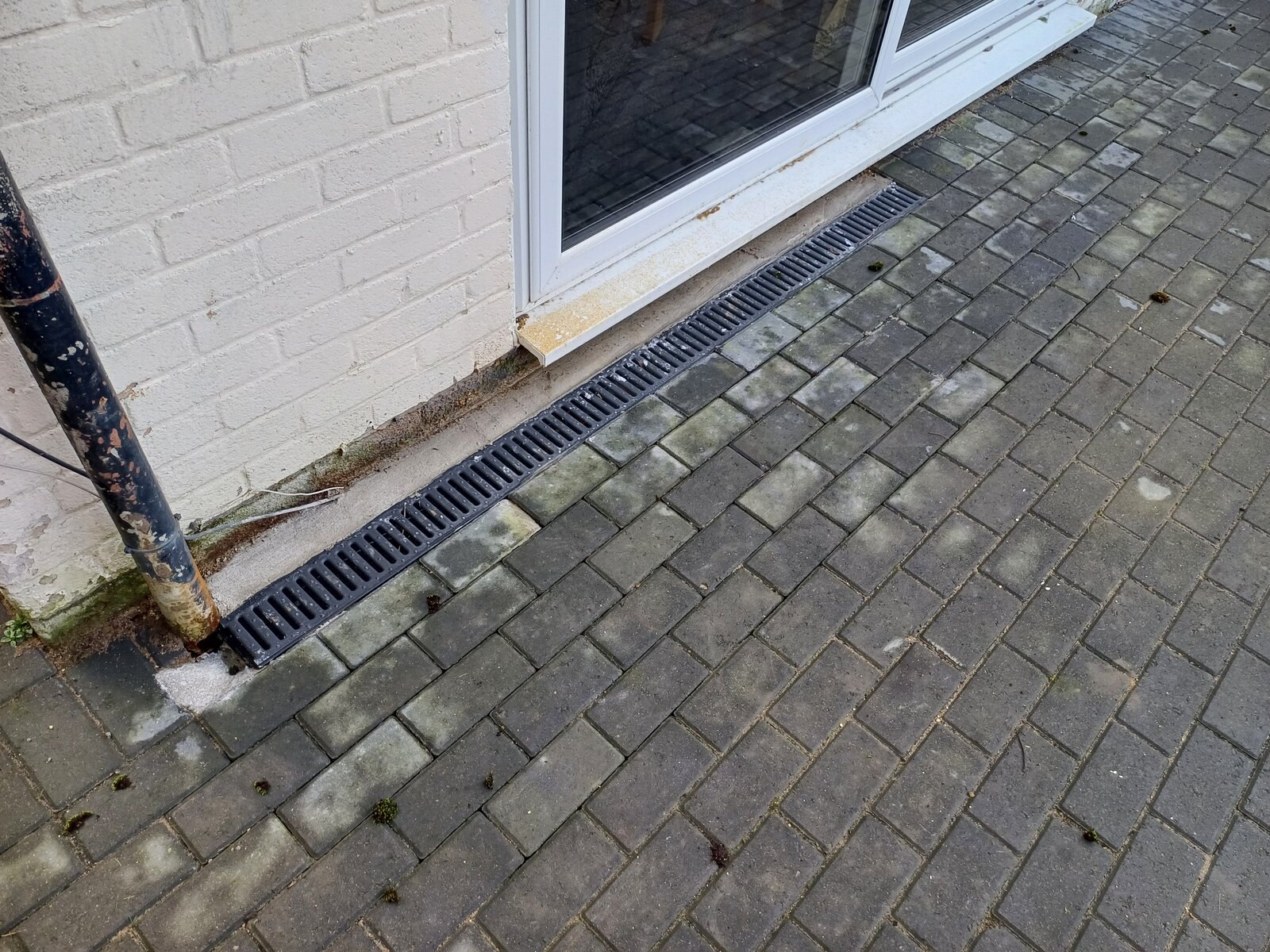

I've attached some pictures below of the drain the company fitted, after 6 months of chasing. They cut through to the downpipe ans made a concrete slope to it.
There is missing sand from some lifted pavers that I intend to fill in.
To the left of the image is the side passage leading to the front. And in front of the the drain is where the dip is most prevelant.

I'd say you need to get someone skilled and bothered in to look at it all as a potential blank canvas and decide what's best.
It's impossible to say just from a photo. Normally an aco drain next to the house would be an absolute last resort where there's a natural slope that way. It would be very preferable to slope away into an aco further away, perhaps running down the centre. That looks like a botch, in terms of where it is and the standard of finish.
The absolute worst case is that it all needs to come up. But even then you still get to re-use all the blocks and hopefully the material beneath so it's not as major as it sounds.
