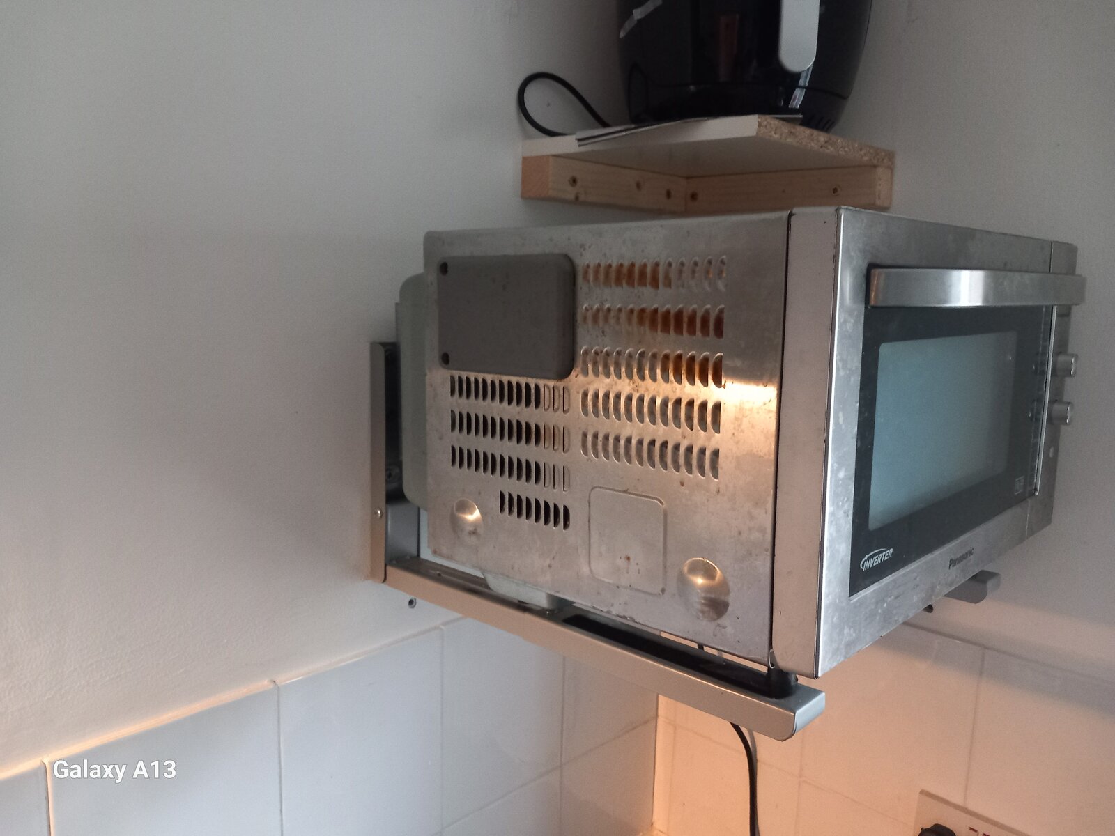

When I put up this oven thing 17kg up it must put much more pressure on the screws than a thin tv as it's far from the wall so I chose 4 x 100mm 6mm screws in 8mm duo plugs. I thought being longer -100mm they'd be stronger but you think I was pointless to use such long screws? Should ve used 70mm x 6mm?

So I've just been using 6mm and 8mm fischer duos think 8mm plug is 35 or 40mm long and 6mm one shorter with all my screw fixings e.g 75mm and 100mm screws so no matter how long the screw. Think Big All said the plug should be same length as the screws not poking out the end? So what plugs do you recommend for longer screws e.g. 100mm/75mm?
4 inch screws for that TV? You sitting on it or watching it? Good grief.
I put a 65 inch TV up in an office and used 4 50mm pan head screws in brown plugs.
As Wayner said - why are you using such long screws?

Think worried that 50mm penetrative into walls isn't enough and whatever was put up would fall down
The force is down not away from wall.
I just looked up and a brown plug will hold 86kg. That's 13.5 stone.
That would take my weight.
Now I used 4 screws so that's nearly quarter of a ton.

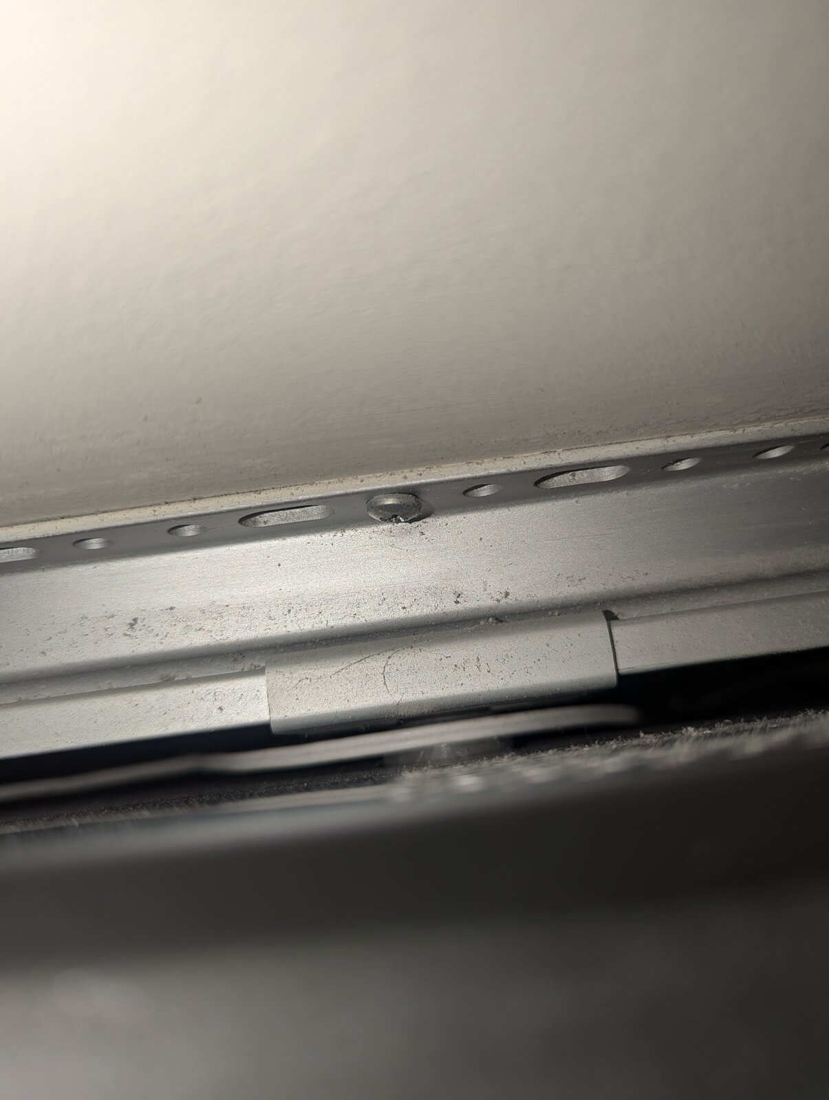

Here is my glass fronted plasma at home. You can see one 40mm screw.
Not moved in 12 years.
