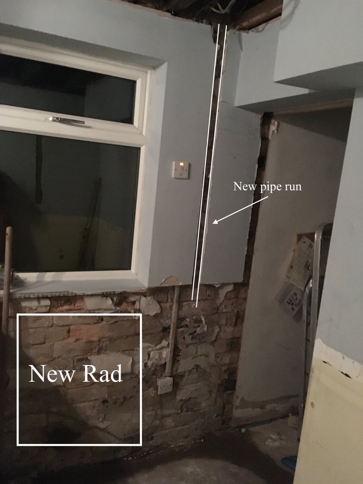

So im fitting a radiator in our kitchen.... the coldest room in our house and has never had one fitted until now. The boiler is above the wall the radiator is going and currently the ceiling is down, so I have clear sight and access to the two 22mm pipes for the central heating. Everything I have done in the house so far, I've used 15mm copper and recently been introduced to plastic and find it much easier and quicker to work with, so I was intending on running plastic pipe to the new radiator, but I have had a couple of questions put into my head that I could do with clarifying please :
1) From the 22mm pipe work should I really be using 15mm pipe to come down to the radiator? this was my intention until someone told me that 10mm would be sufficient and would be easier to manoeuvre when exiting the wall and running along to the radiator valves. I intend to fit a 600x600 single panel radiator....
2) My pipework will run down the wall then turn left towards the radiator. Im thinking that the pipes would be better coming out of the wall downward facing so as to bend off left and right to the valves. Again, someones told me "nah.... you'll be right... just bring the pipework across the wall and use angles"... (the plasterboards off in the area at the min too so everything is easy to run). So basically.... am i right in my though of coming down the wall, turning left then turning down the wall again down the centre of the radiator to pop out of the plasterboard (when fitted) to turn off to the valves.

Yes, 10mm will feed a rad of that size no bother, especially if it's off the main 22mm flow and return.
If you are doing drops you may want to think about a drain on that rad supply too.
Most if not all professional trades run everything in relatively straight lines. I'd avoid angles where ever possible
brilliant.. thanks Madrab.
I'll try and get a picture of the wall I'm fitting it to which will hopefully explain why I think I need to turn... although... will 10mm just turn..?? I'll get a pic...
I'll never be Bill Gates, but Ive taken a pic and put some lines on and things to show the positioning.. The only thing I seem to be encountering is 10mm plastic pipe doesn't seem so readily available in 2/3 mtr lengths, just long coils which is excessive for my needs.

Just do it in 15mm copper. It's a simple run and you won't need to worry about the plastic fittings leaking in 10 years time from being so close to the boiler.

10mm pipe isn't much different price than 15mm in plastic but it's much easier to run and would be enough.

Thanks John..! I was hoping to use 10mm but I only need just over 7 metres of it and typically I can’t find it in anything shorter than 25m coils, unlike the 15mm which I can get in 2 & 3m lengths.
Just out of interest.... would having a double panel 600x600 affect any of the pipe sizings ive mentioned??
No for 7m total length even with a 11c temperature drop it would be ok. You do have to watch both water velocity and head loss though but you can calculate to be sure. I did a 12m total length no problem on a similar rad although I'm designing for a 20c drop in my system.
