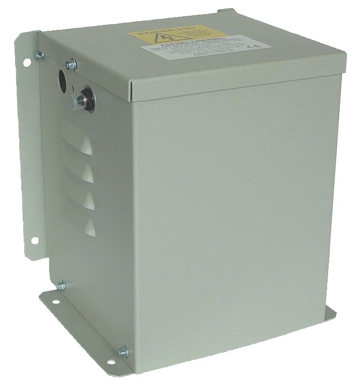

1) As already said frequency could be a problem.
2) Yellow bricks are designed for intermittent use.
3) Yellow bricks are overload protected on input not output so any load phase to earth can demand twice the current from a single winding to what the overload is designed to limit.

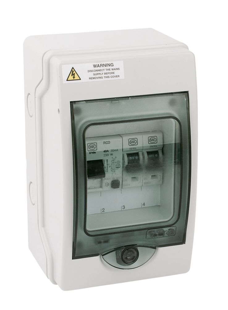

So the supply should really come from a continuous rated transformer a transformer of this type is far better for long term use. And the output would go through something like this with in the case of transformer shown a 16A double pole MCB. It may also be required to disconnect the central tapped earth and connect one of the lines to earth instead if possible as with many the centre tap is internally connected to earth and I have needed to order a transformer specially designed with no centre tap for USA equipment before now.
Even this does not redress the 50Hz to 60Hz problem and only the supplier of the equipment can tell you if this is a real problem. But since it's the transformer not the equipment burning out I would guess either the centre tap, or the rating/type, together with protective devices on output not input is the problem.
