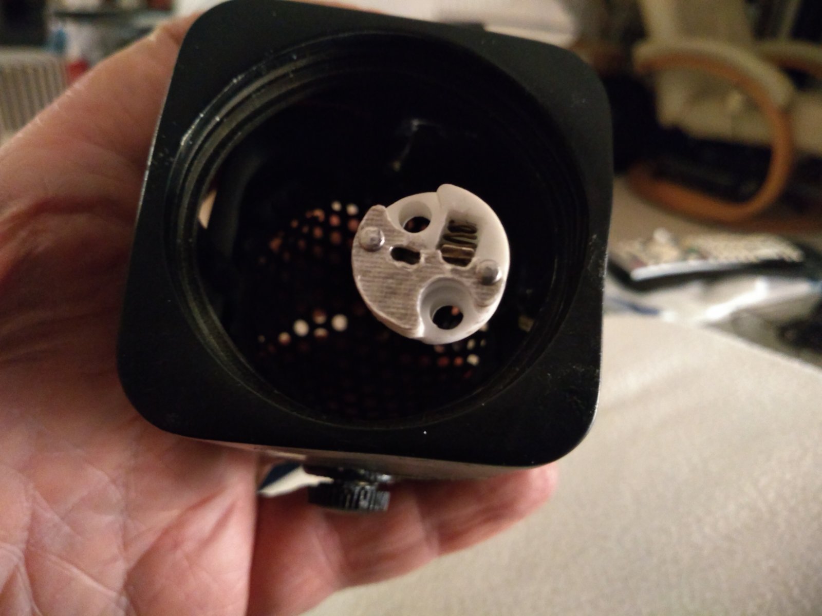

I had to replace a 50w bulb in a 12v spotlight track fitting, after replacing the light still didn't work and I noticed that part of the silver/metal covering on the connector is missing, as shown in image, could this be the reason, thanks

Thanks, thought it might be the built in transformer but obviously
the connector will be the cheaper option
What does that missing bit of silver do, I presume part of the circuit but not sure how,,?
The low voltage and high current, plus heat and sometimes poor quality connections mean they do often fail. Might be worth your while fitting a new lampholder and swapping to LED, if an LED can be used in that fitting. They are much lower current.
