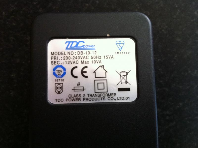

This is the wallwart transformer:

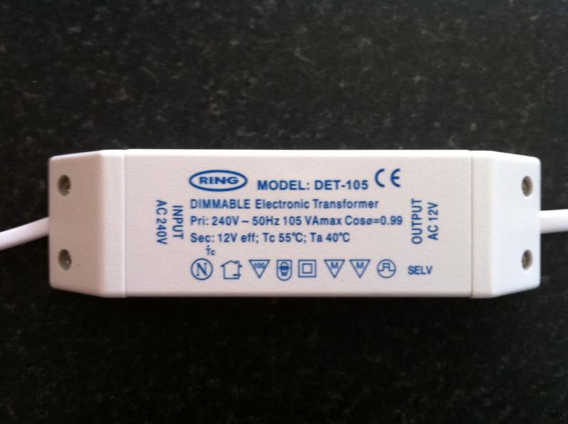

This is the transformer I would like to use if suitable:

Although the instructions state the supplied transformer is 10VA, its actually 15VA.
Each deck light uses about 0.3W/0.3VA. If I use all 16, I would be drawing 4.8VA?
Do I simply need to check what the minimum VA I can draw from the Ring transformer?
If not, could you give me a link to a new transformer? Preferably on Screwfix.
Yes, you would, which is less than 10VA, let alone 15, so you can use one of your wall-warts without worrying about compatibility, and keep the other as a spare.

The transformer supplied appears ( from it's size ) to be a true transformer and not a switched mode power supply that the white one most definately is.
The true transformer provides sine wave 12 volts.
The SMPU produces "12 volts eff" ( effective ) which can be rapid short pulses of maybe 24 volt (or higher ) that average out in the lamps to be 12 volts.
Most filament bulbs will work on the 12 volts eff as they will average out the voltage,
LEDs supplied by 12 volts eff may be destroyed by the pulses that are more than 12 volts sine wave AC.

But the LED lamp units that you have ( which are one or more elements fitted it into a holder ) will almsot certainly have the necessary current controller{s} included as part of the fitting. Other wise they would not be able to run on 12 volts AC that the recommended transformer supplies.
