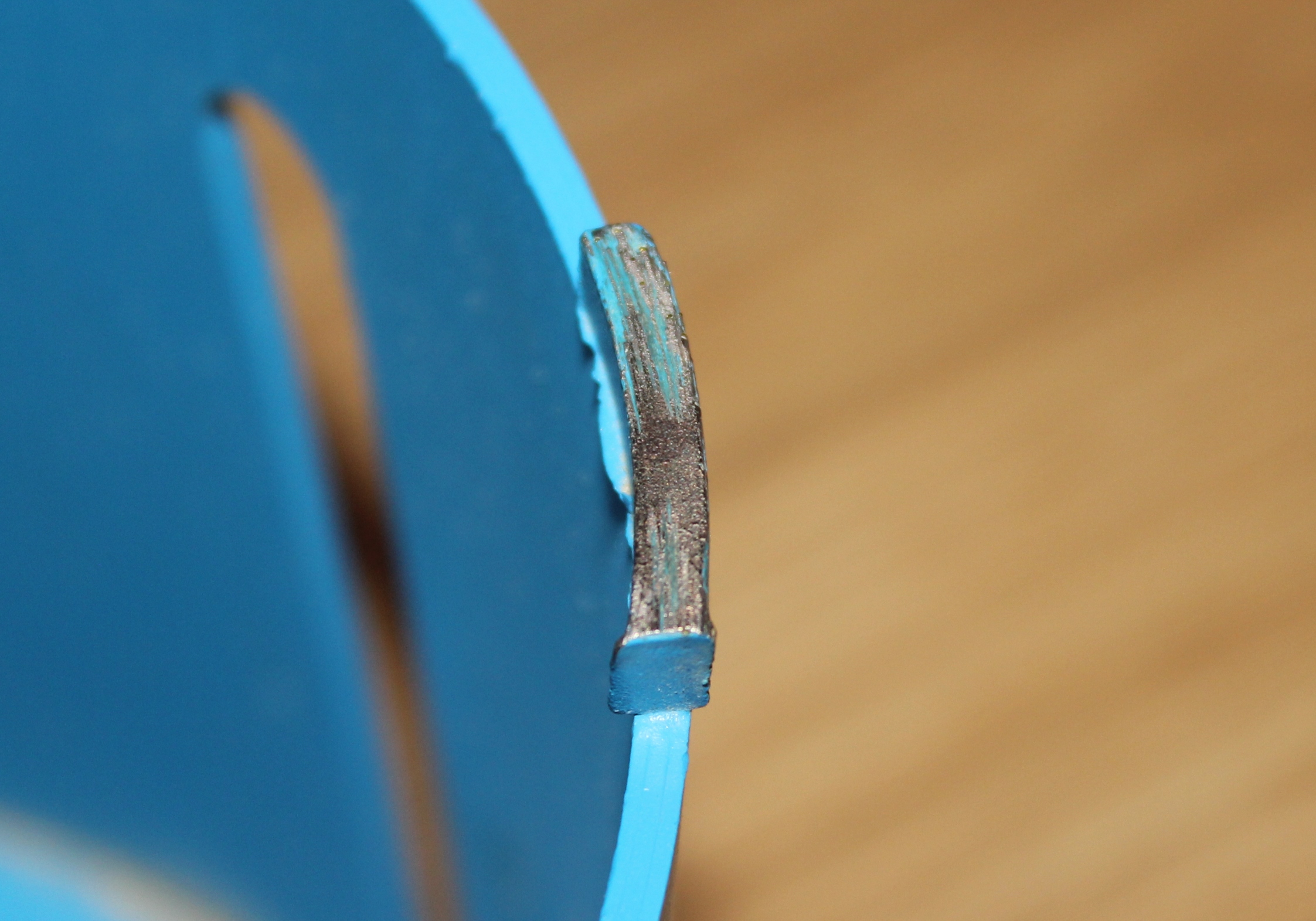

Just bought this off eBay for £35 inc P&P (Included hex arbour kit not shown) as I need to drill a 6"/150mm hole through a wall for a short piece of 6"/150mm (External diameter 156mm) solid ducting what is to be used as a exhaust outlet for a portable AC Unit.
Now the brand is SilverLine and the box says it is "diamond core", however the amount of effort to get through a bit of 6mm plywood as test for the hole size was unbelievable!
Is this because the core drill is blunt and a knock off OR just because the plywood was to soft to grind away at?
The wall I am am hopefully going to be drilling through tomorrow is breeze block with insulated plasterboard on the inside and smooth render on the outside. Using my 18V Dewalt cordless drill.

Can't see that clearly, but it doesn't look as though there aren't many diamonds in it. Silverline are normally cheap, but basically okay, so I think you've got a knock off there.
Having said that, I'm not surprised you can't get through the plywood; too soft to be ground away. Wait to see what happens on the breeze block.

A dry diamond corer won't cut wood for toffee, too smooth a surface. A diamond core needs a hard surface to keep the diamonds in the segments exposed, all the wood will do is create too much heat and polish the surface.
You may need to chap those segments up, looks like they have become smooth and the diamonds need to be exposed again. Cold chisel, and chap light marks into the segments if you find it won't bite, or a senior hacksaw and roughen them up.
