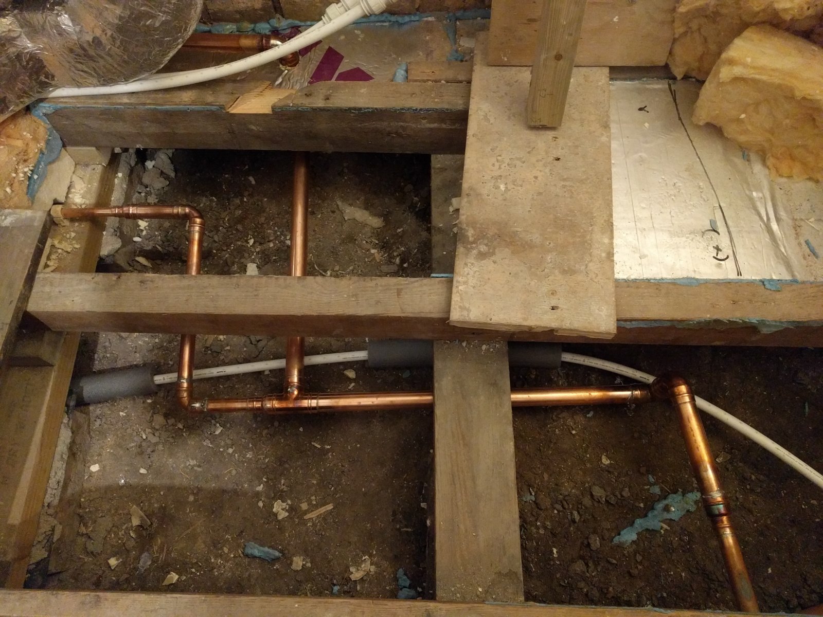

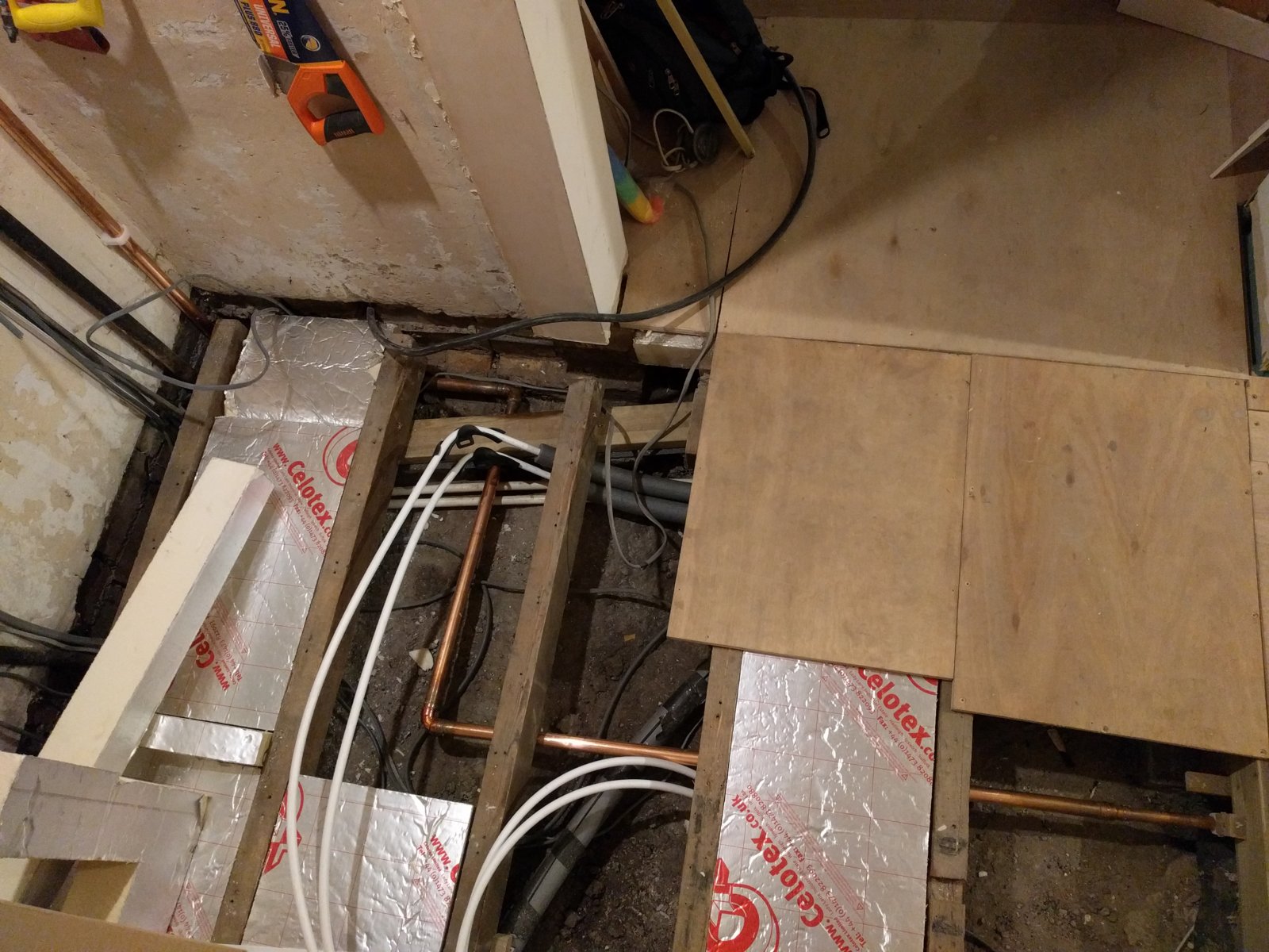

Would be, unfortunately that specific part of the floor with the elbow isn't up and has a 110mm branch pipe and kitchen ventilation fan/intake fan in front of it. I'll have to remove them before hand. Got to be done though!
Where you've got access and it looks like you've got access from the images you can always get around getting pipes in !
You know those metal puzzles when you were young ? where two pieces of bent metal are interwoven and you have to seperate them and put them back together ??
Early training devices for plumbers !!
On odd occasions I've had to make up a pipe assembly using benders and fittings, sweat it up and then wiggle and manipulate it in to position to leave two ends that you can then easily connect to ( because it would have been impossible any other way )... you just have to think outside of the box sometimes .......

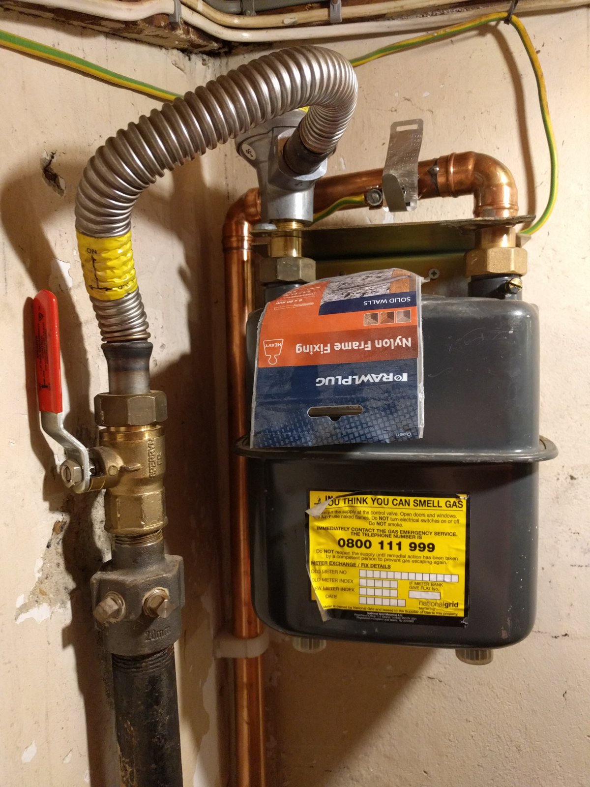

Ah right actually that image is all 22mm and good access as we are insulating the floor, that's the bit near the meter that could do with reorganising. But the 15 is harder to get to below the boiler.
I'm sure it's doable at some cost, although now you've got me thinking maybe I can just fit the pipe in place with bare open ends ready for a fitting, then the gas guy just has two joints to attach, then I can pull out the old pipe. Soldering a pipe isn't a problem for me it's just the checking the combustion afterwards.

Remember you can have the pipe size upgraded anywhere on its route to decrease the pressure drop on the entire run. Just have the bits done which are accessible to 22mm or even 28mm.
Trouble is by my calculation there's nearly 1mb drop just on the hard to access 2m plus 2 elbows of 15mm, so the whole rest of the run which is not all accessible either would have to be 28mm or more.

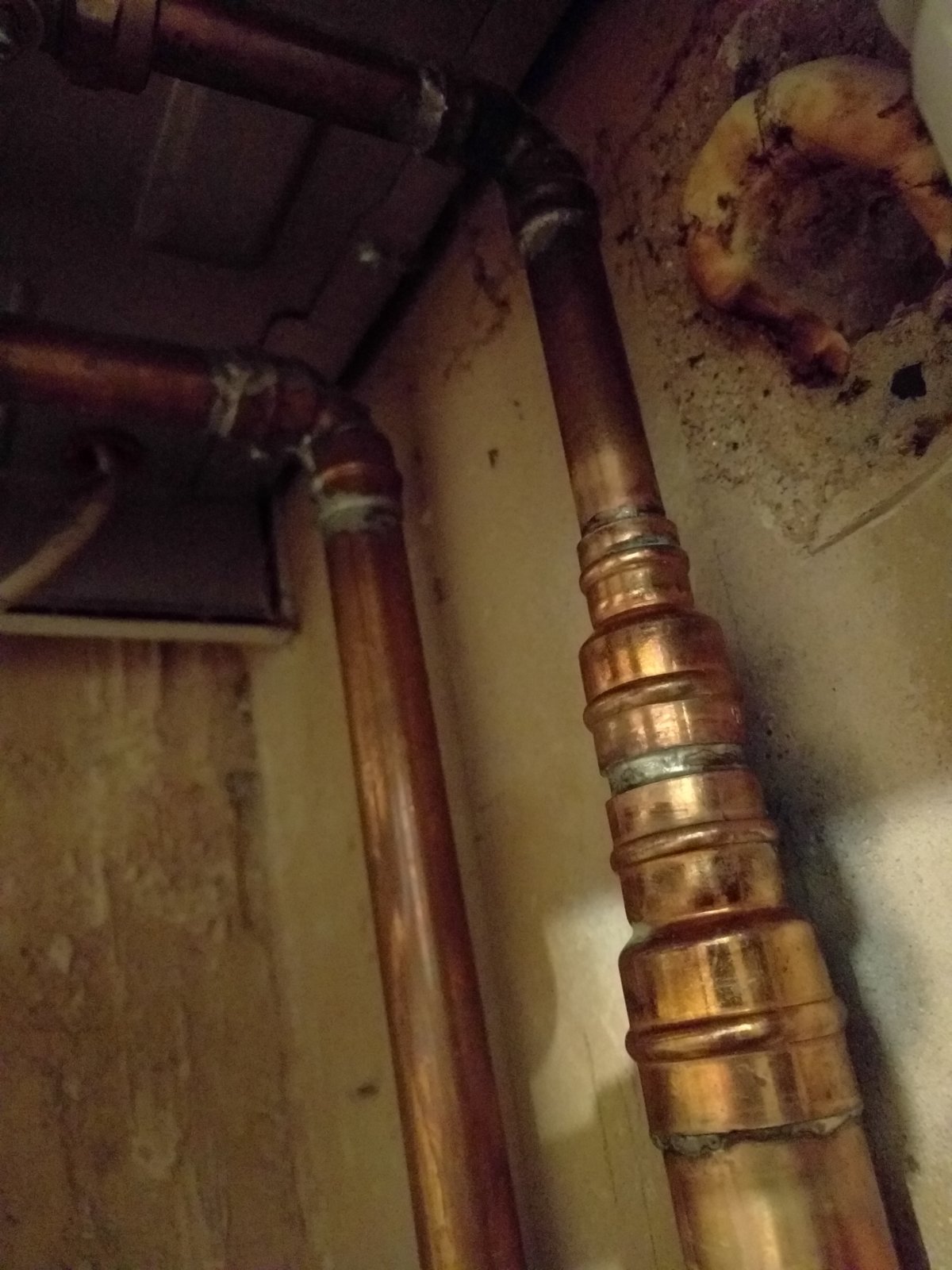

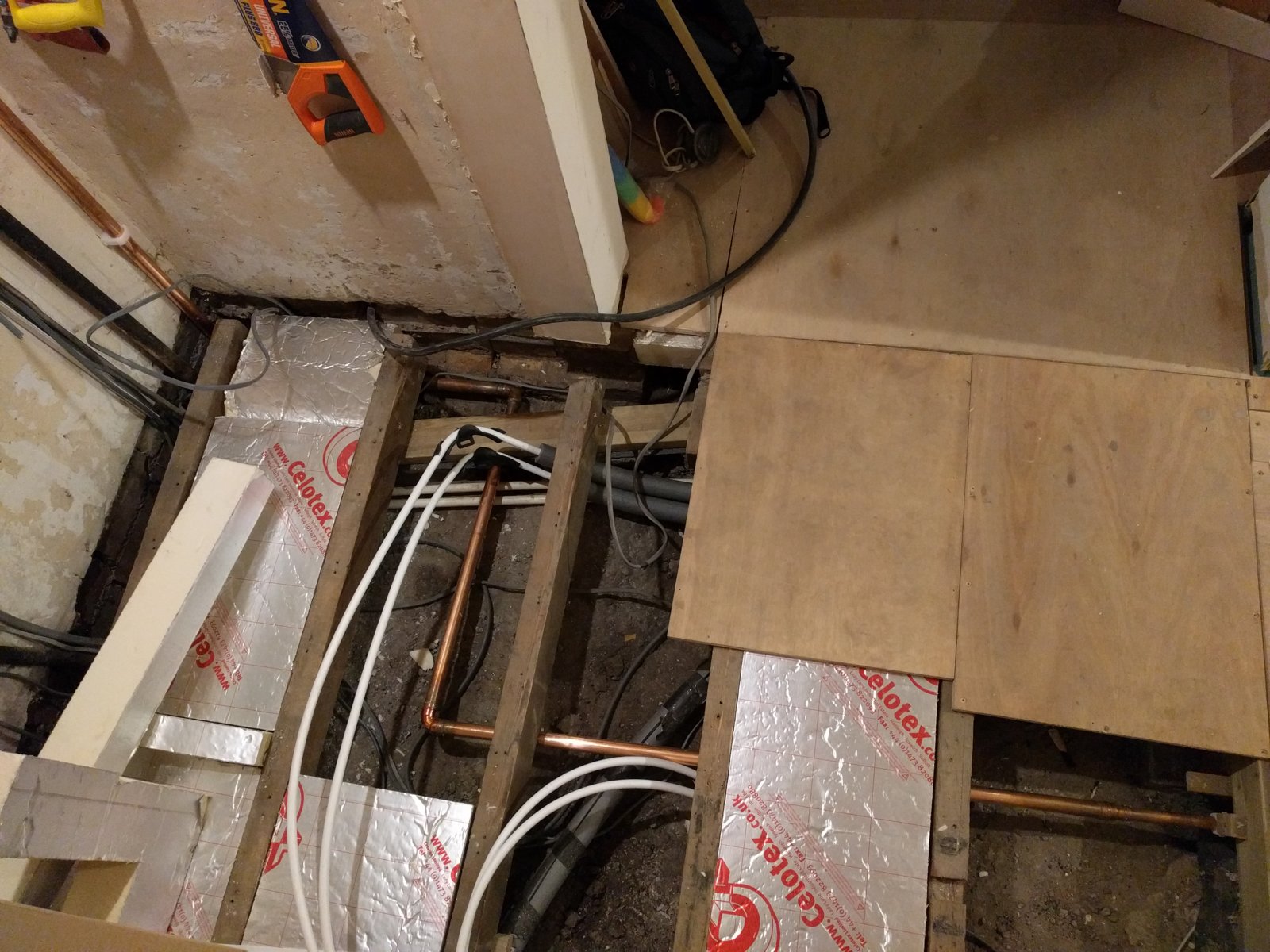

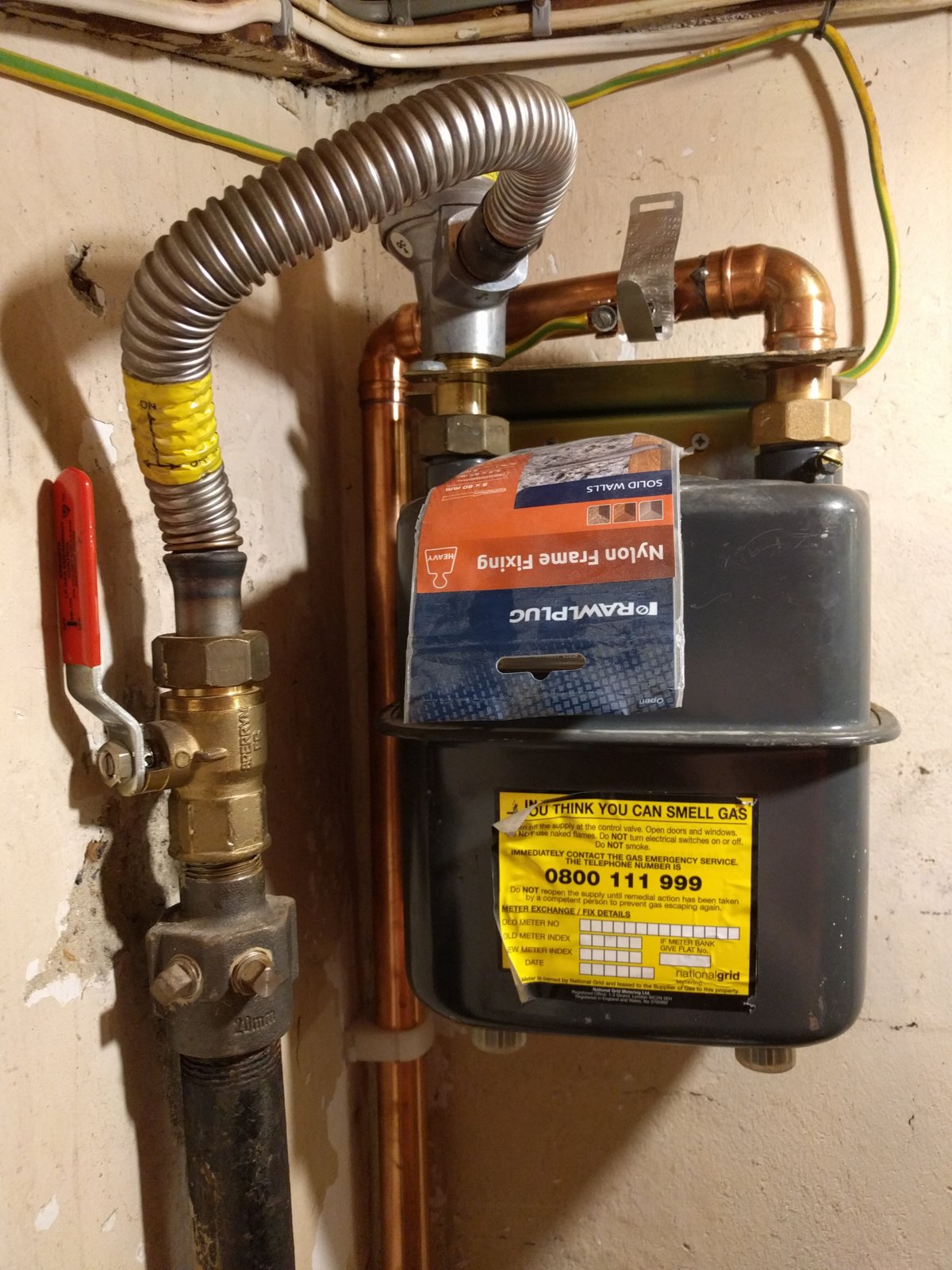

Well just to close this thread, thanks for the help and we decided to sort it all while we can, so the whole run is 28mm apart from 3m of inaccessible 22mm and the last few cm of 15mm at the boiler.
According to the tests the meter working pressure is 19mb, the boiler is 17.5 which is within spec and the hob is 21.5. I was surprised but apparently that's not uncommon depending on the pipe run? Everything else looks ok but I get the impression the testing isn't as strict at I thought.
Anyway it all looks good and we should be future proofed,I took a pic for posterity before we finish insulating.
