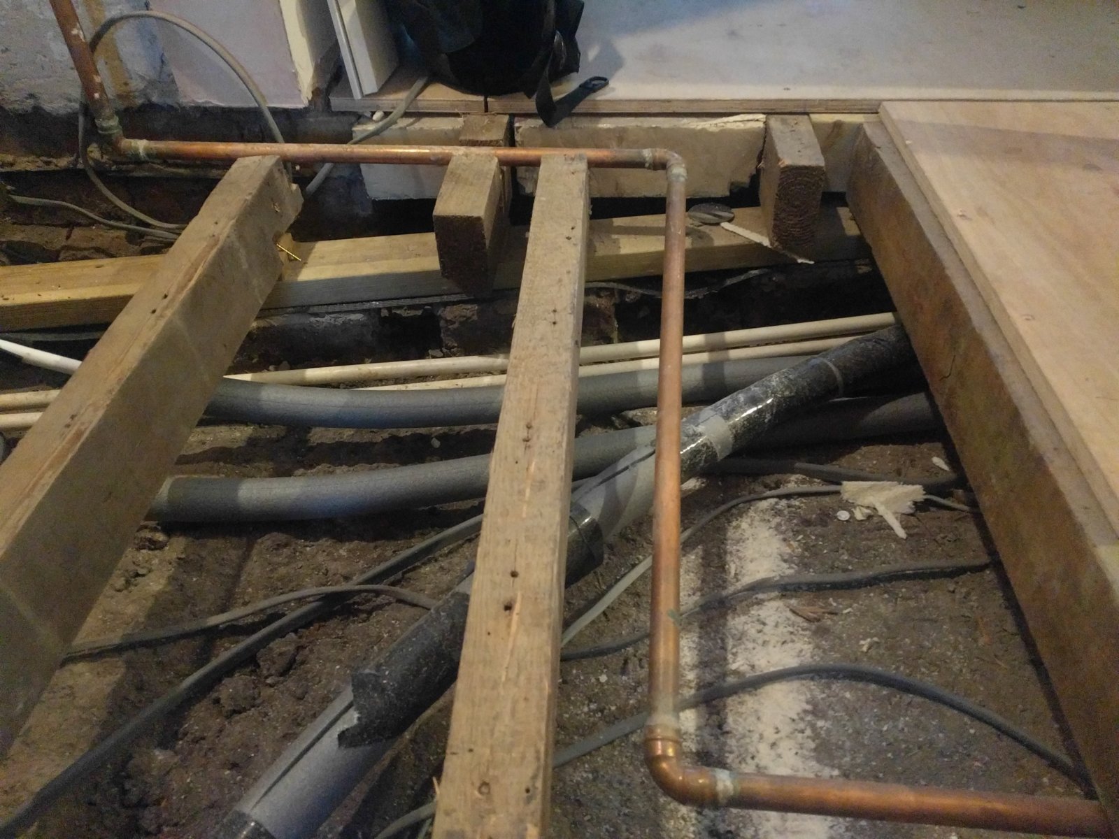

Our boiler vaillant ecotec 24 pro was installed in 2012 by the previous owners. No documentation whatsoever. The guy who owned the place before made a big thing about how they had a completely new gas pipe run for the boiler.
Recently I took up the laminate floor to find the gas pipe directly below the floorboards which didn't seem ideal but probably OK.
Looking at the gas pipe near the boiler its a 2m run of 15mm with one elbow, and the rest of the run is around 9m of 22mm with 7 elbows including a tee t the hob.
Now I tried to check the pipe sizing using a PDF calculator and I got around 1.3mb.
Basically my question is should I be concerned?

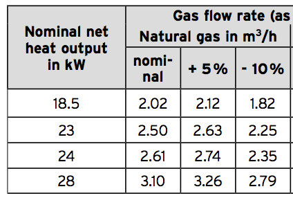

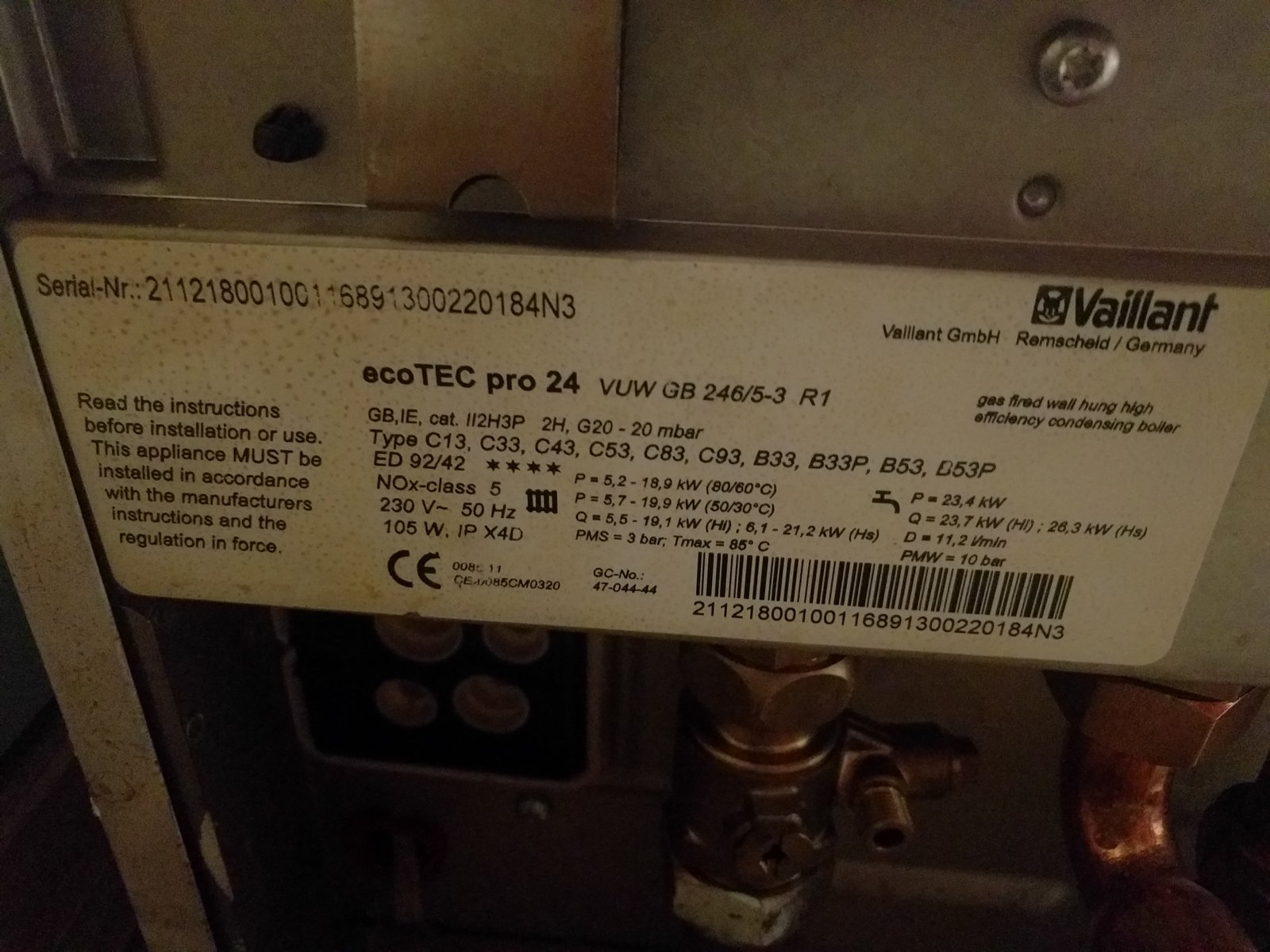

I've run the boiler on P01 test program for 1 minute and got 1.4 turns of the dial which is 2.38m3/h. The rating plate of the boiler has so many different power ratings I'm not sure which to use.
P01 is "maximum heat input"

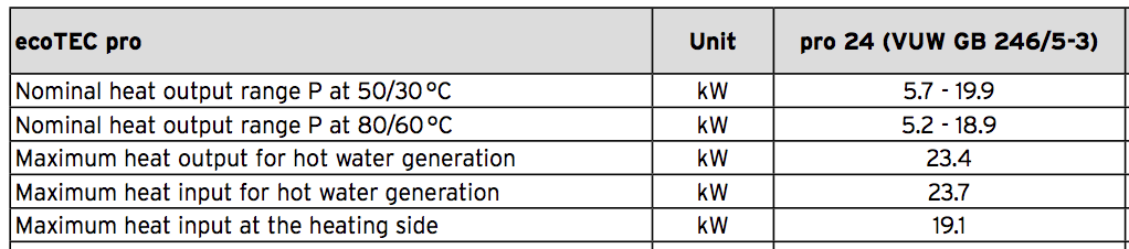

the specifications say on p63 of https://www.vaillant.co.uk/downloads/ecotec-pro-instn-maint-261423.pdf (sorry about the size):
The table in the section on checking flow rate talks about "heat output" not input on p35
So 2.38 is just about in the range for 24, which is in the model number of the boiler..! Any thoughts?

Boiler rating plate:
Gas pipe of concern down from the meter and going across at floorboard level:
PS we've had absolutely no trouble whatsoever with the boiler (touch wood) it's got excellent hot water and it heats the rads really quickly, no strange noises or errors etc.
I've looked a bit more in the manual and it says it should work down to 13mb, so that sounds like there shouldn't be an issue. I also realised there is an extra 90 elbow I didn't spot in the 15mm pipe right at the boiler!

The 13 mbar is measured at P1. It is to take into account pressure loss across the internal gas train.
Thanks Dan, well it sounds like the real problem will be when the boiler's changed and can't be commissioned. We won't want to rip any floor up then, so given the floor's partly up now it sounds like better to get it done now! And we can get the ridiculous pipework sorted by the meter in one go.

It's nothing if a job to replace the 15mm that's under the floor with 22mm, it's not even a full length if copper.
Simply put in the 22mm, come up vertically with a 22mm elbow a small length of 22mm then a 15mm reducer. The 15mm can always be replaced at a later date as it will be seen that it's 22mm coming up from under the floor .........nothing of a job.
Would be, unfortunately that specific part of the floor with the elbow isn't up and has a 110mm branch pipe and kitchen ventilation fan/intake fan in front of it. I'll have to remove them before hand. Got to be done though!
