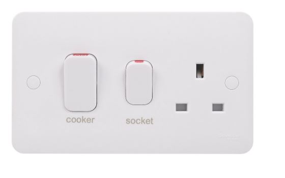

16Amp oven connected to 32A shared
24 Apr 2009
33
Leicestershire
I have a 32amp mcb for an oven. The oven is connected to a 2 gang cooker switch. Is it okay to plug a pizza oven rated at 16amp. this is not for permanent use just like one a week for an hour or so. I wont be using any other appliance at the same time.
In order to determine the actual current needed, we need to know the power consumption in kW. Then we can determine what the actual current requirement is. 16A may just be stated because it's designed to plug into a continental 16A radial circuit.
