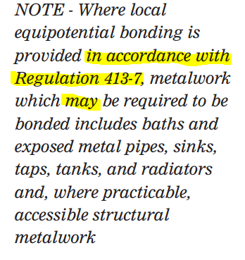

Copy of relevant part of Wiring Matters magazine from which my qoute above was taken is:
supplementary-equipotential-bonding.pdf
That the writer of this publication did not understand the whole concept of earthing is hard to believe since it is written, and distributed, within a publication from the IEE, the compilers of the wiring regs.

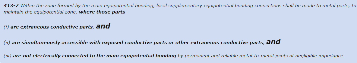

I think it was the 15th regs heres an article
https://electrical.theiet.org/media/1620/supplementary-equipotential-bonding.pdf
That is the same as posted by Alan.
It does not say bonding should be applied to parts which are not extraneous-c-ps.
It would appear that the bond everything era is a myth brought about by not reading the regulations properly.
Much the same as today -
if you ignore half the text then it does look like lots of things must be bonded.
Solution - Don't ignore half the text.
