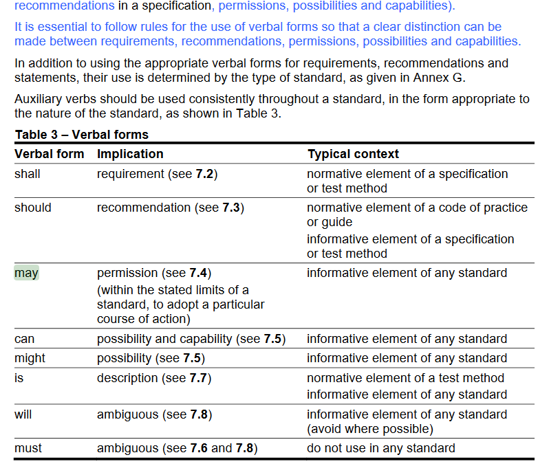

Although I find it hard to believe that BAS is not being deliberately obtuse, here is a short excerpt from the rules which cover the wording of BS7671.
I am not being obtuse, either by accident or design. I genuinely was unaware of the rules which you showed.

But basically, Detlef, no matter what the rules may say, it is demonstrably obvious that there are dozens and dozens of instances in BS7671 where "may" does not mean permission, but does mean possibility.
To accuse me of being obtuse because (a) I was as unaware of the rule as the authors appear to be, and (b) I did not think it possible that what they meant was "Wiring systems hanging across access or egress routes are permitted to hinder evacuation and firefighting activities", and that therefore there was an ambiguity which should be removed is not really on.
IMO, anybody who cannot tell from the context whether "may be" means "might be" or "is permitted to be" when it matters probably has no business trying to do electrical work.

Interesting how you've missed the point BAS. The original post from EFLI was pointing out that the IET were not following their own rules (and indeed the rules of all the other organisations that publish standards). You have indeed backed up the statement that they don't. Well done.
I must admit that I've been aware of the special usage of these words for about 40 years. I guess you youngsters were just never exposed to this.
Same here (but 50+ years) - probably the consequence of being the son of an excessively obsessive 'old school' Standards Engineer!
