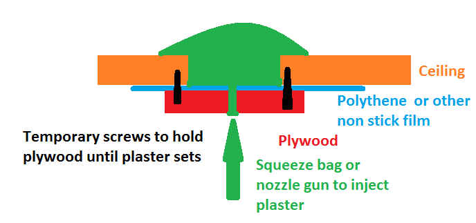

I have a ceiling that I want to re-skim. It currently has 19 small spotlights in that I'm removing - the cut outs are about 25 to 30mm in diameter. I cant really reboard the ceiling due to coving, and it seems a bit overkill to screw wood batons and plasterboard into each one.
Do you reckon boding plaster would do to fill them, scrim over and reskim?......
Any other other ideas welcome.....
take a bit of plasterboard just big enough to poke through the hole. In the centre, run a bit of string through it. Butter inside the ceiling with some coving adhesive and using the string, manoeuvre the strip so it sits on the adhesive and can be settled in position. when it's dry you can fill it.

what about a strip of plasterboard that fits through the hole - use plasterboard screws to hold that either side (use string to pull it)
then a hole drilled into scrap plasterboard of the same size (the bit from the middle of a holesaw) and screw that onto the plasterboard strip ?
Using "liquid" plaster or even expanding foam this might work
no need for anything elaborate.
for 30mm holes then simply force up a blob of any kind of tub filler or semi-dry plaster powder.
as it sets, smooth it off, and as the ceiling is skimmed then tape over the holes.
Cut out plaster pieces with the correct size. Cut small timber batten, put over the hole. Pull down with looped string and secure with plast screw. Screw round board into hole. Fill with filler. Job done. Be done in a coupla hours or so.
There's a guy on youtube who does it like this:
Take a hole saw, that's larger that the hole (or the same size).
Take some plasterboard the same thickess as what's already there.
Use the hole saw and cut only part way through.
Turn over
Use a knife and cut the paper larger than the hole-saw cut
Snap off the excess
You're left with a puck of board with an oversized piece of paper still attached.
Smother in muck.
Oversized paper holds the puck in place and muck in combination with paper fills the gap
you're left over with only a small hole the size of the drill bit in the centre of the hole saw
Also works well for smashed holes in plaster boards - so long as you have a large enough hole saw!
