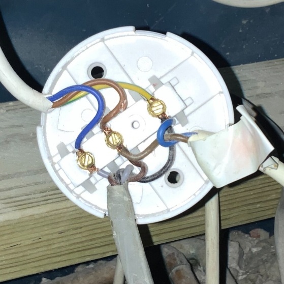

And to cement the point, here is a pic of an abomination found in the plumbing forum!
The top cable is L, N and S/L from the boiler. The only marking was some felt tip on the green/yellow at the boiler.
The right cable goes to a thermostat that was about to be replaced - green/yellow cut off here, but exposed at the thermostat and S/L becomes blue - no sleeving or markings anywhere.
Both this junction box and a second thermostat (connected to the bottom cable) were unknown to the original poster. It was very confusing for them!

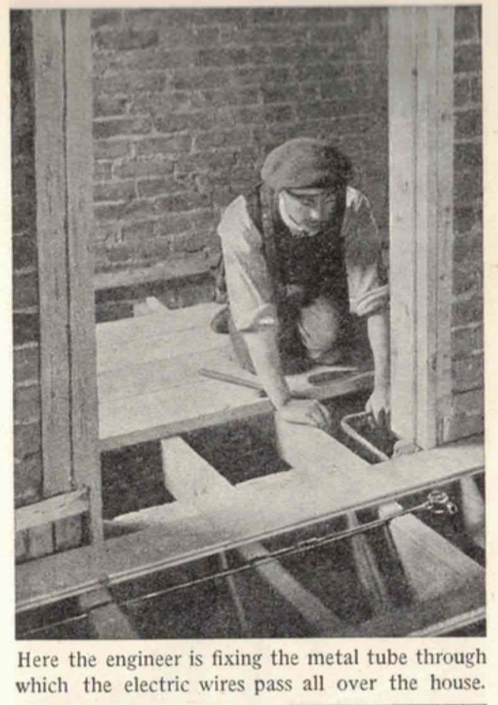

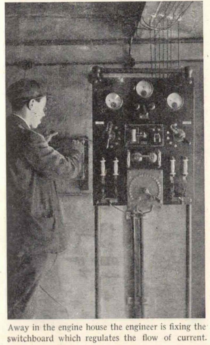

Ring mains have been in service for a century or more. Sadly I threw out a load of books etc handed down to me by an elderly friend a few years back, one of which was akin to our current OSG which clearly showed how to install a ring main in a house using porcelain or glass insulators
And if anyone is interested in a few photos showing the construction of a house in 1913, I recently came across these:
Unfortunately, there are only a couple of pictures of the electrics :) :
