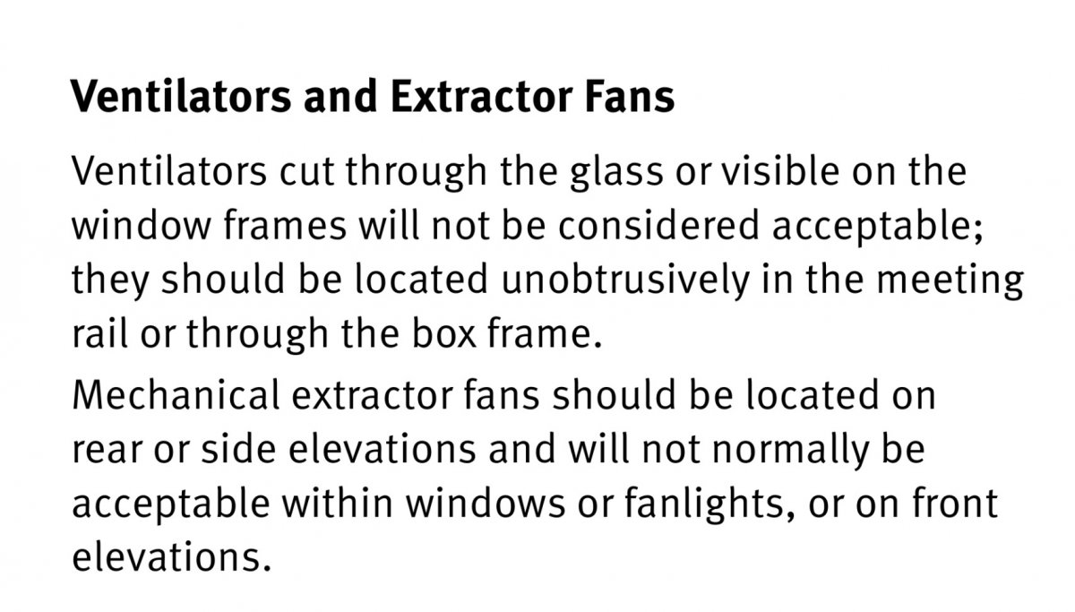

Is the building listed or in a conservation area?
Not listed but it is in a conservation area. I'm assuming what you're next going to say is I need to apply for conservation area consent.
I was going to say that fans in windows might be discouraged in listed buildings and conservation areas (they are here).
I'm unsure about the rules. Is it on the principal (front) elevation?
It is.
I hired a kit at work and the wear charge was more than I could have boight the Mexco full kit for.
You might like to at least see if there are similar vents visible on other properties, see if there are published guidelines etc.
That is from Edinburgh's listed building and conservation areas guidance.
