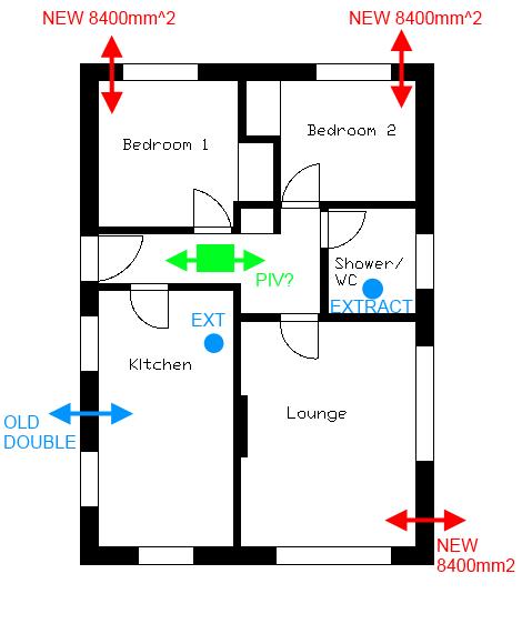

I have done a quick roughly to scale sketch of the floor plan. The right hand wall (as drawn) is North East facing. The worst rooms for condensation are those labelled Bedroom 2 and the Lounge. Relative humidity hovers around 65-70% with 19-20°C. With the windows locked open for 24 hours and heating on full, temperature was 24°C with 50% RH.
There is currently a double terracotta air brick in the kitchen, about 5 foot from the floor level. (plus another single air brick behind the cupboards) Everything in blue exists already. Red is what I'm proposing as additional.
The front door shown here opens to a double glazed porch area (not drawn). As such I'm not sure that there is any significant air change when coming and going to/from work.

2. Fit 3 additional wall vents in the positions shown in red each providing 8400mm2 unrestricted area. I am considering the Ryton AAC125HP, for reduced noise transmission.
3. Fit a PIV unit in the loft (Nuaire Drimaster) in the position shown in green. But then would this require some trickle vents or wall vents be fitted into the windows anyway, to be effective.
The area provided by the three new wall vents seems to provide sufficient ventilation for the size of property. I've positioned them diagonally opposite the door in each room - is this optimal?

As far as I can see, the nuaire drimaster, just blows air in from the loft. So you need vents to let your hot and damp air out.
If you are going to make holes in the ceilings for vents, I would spend the extra on a proper heat exchanger system. this will pre heat the incoming air by the warm air you are venting. It could be a closed system (in theory), with the only outlet is the condensation drain. In reality cold air is taken in, warmed up by the warm air you are venting, so you get warm DRY air as the input to your rooms and you have a drain pipe where your condensation drips from. This is actually problematic as the unit will sit in your freezing loft, so the drain pipe can freeze up, but the condensation keeps on coming so could drip out onto your ceiling. Manufacturers normally include an electric heating circuit actuated by a thermostat to keep the thing "unfrozen".

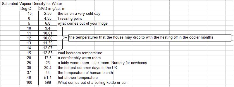

Relative humidity is a fairly meaningless concept when talking about condensation - the saturation vapour density and dew point are more relevant.
SVD is the number of grams of water in a cubic metre available to condense on colder surfaces than the air temperature, and the dew point is the temperature that the humid air reaches 100% RH, and starts to condense.
Here's a table to get you thinking:
You can see if your window is 5 deg C, and the room air is 20 deg C, there is the potential for every cubic metre of air flowing over the window to condense up to about 10 ml of water.
