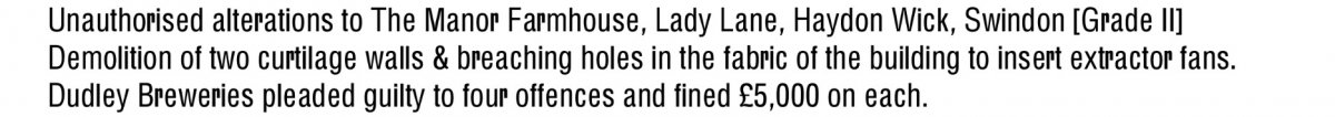

Just for fun:
http://ihbc.org.uk/prosecutionsDB/Prosecution Table 1 Size of Fines.pdf
So far can't see anything that needs consent for a vent. I'll have a look at the road first before deciding.
