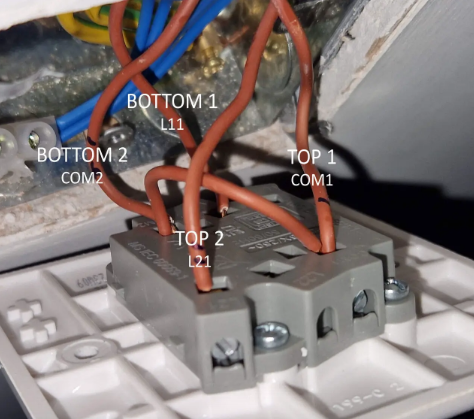

I have never come across this before, so I hope you can give me some direction here. I can normally swap switches and sockets without changing any configuration, but it didn't quite work out this time around. I always mark cables and take photos.
I have 2 lights in the main bedroom upstairs with a standard on/off switch (no other switch in the bedroom). I put on dimmable led bulbs, and I wanted to install a dimmer switch (2G). Didn't quite go according to plan.
First thing I noticed is that when the bedroom switch is disconnected, other bedroom and toilet lights don't work. Somehow, entire first floor lights depend on the bedroom switch. Is this normal?? I found this a bit strange.

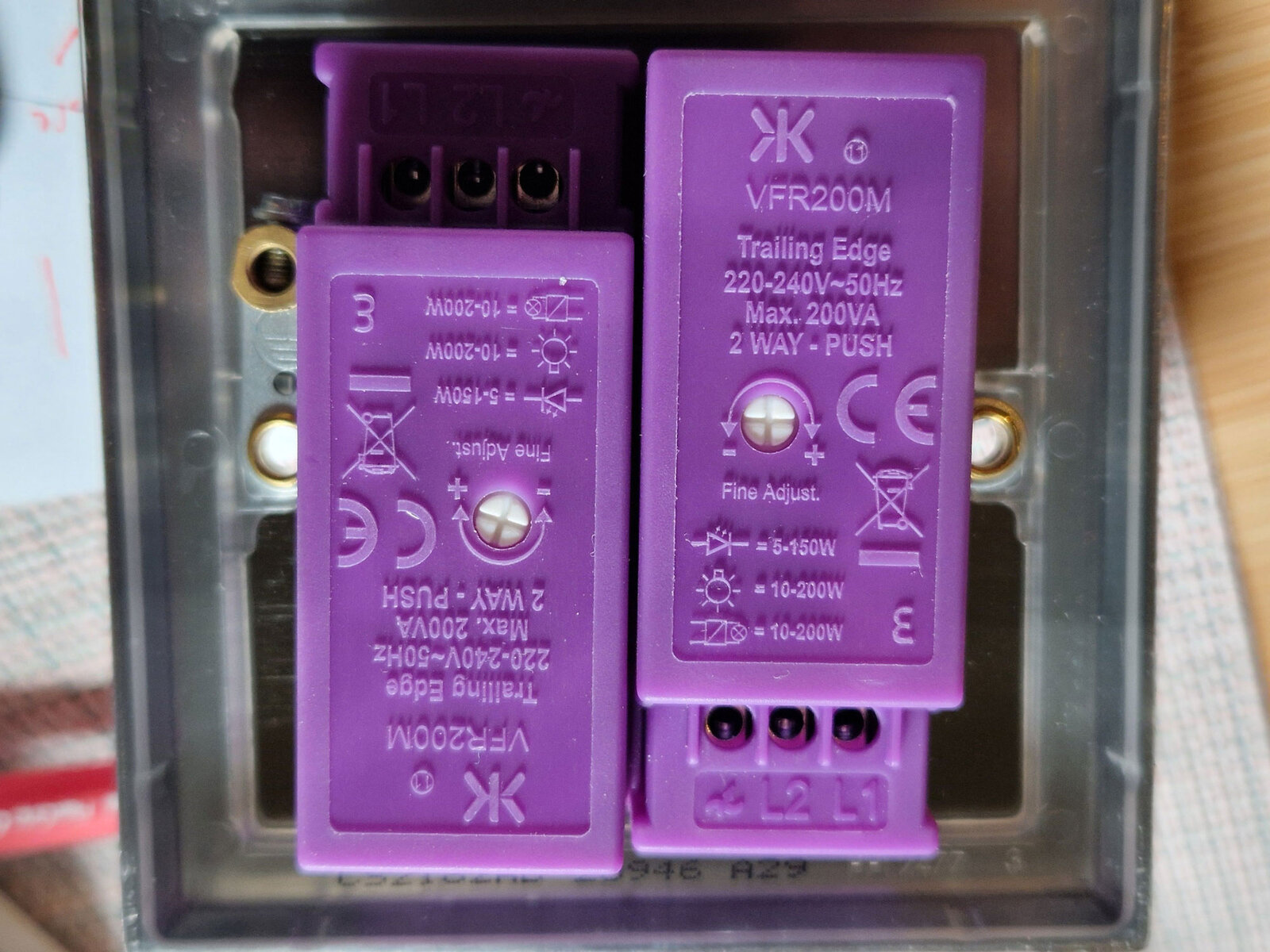

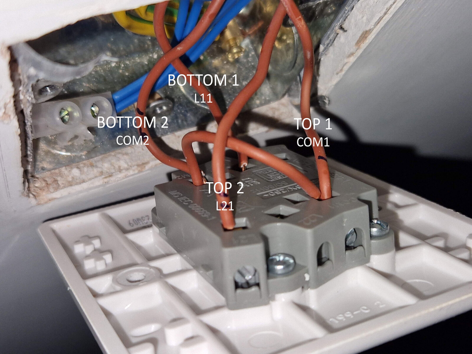

Secondly, please see a photo of the original switch setup (untouched). I put lines on the cables to ensure I can revert back (and I had to). For ease, I noted them as Top1, Top2, and Bottom1, Bottom 2. I would really appreciate it if you can let me know what the correct configuration is on the new dimmer switch. I tried replicating the same setup (although I wasn't sure about the L11 L12 L21 L22, which didn't correspond with the simpler L1 L2) but it either didn't turn any lights at all, or it turned on/off other rooms lights (I left them switched on).
I hope I explained this correctly, but if you require any clarification please let me know.
Thank you very much in advance!

Bottom 2 and Top 1 are the supply, and should be connected to L1 on each dimmer, including the link between them.
Without the link, lights in other rooms will not work.
Bottom 1 and Top 2 are the connections to each light, connect to the wavy line terminal on each dimmer.
L2 terminals on the dimmers are not used.

Com1 === L1 Left Dimmer (live - in this case coming into room)
L11 === SwigglyLine Left Dimmer (switched live going to a light)
Com2 === L1 Right Dimmer (live - in this case going off to also power switch in next room)
L21 === SwigglyLine Right Dimmer (switched live going to a light)
Jumper wire between Com1 and Com2 === Jumper wire between L1 Right Dimmer and L1 left dimmer (this is to join live coming from Fuse box, to two swiches via jumper wire, and then off to the light switch in next room).
The wire coming into Com1 is likely to be live coming from the Fuse box (probably via other light switches).
It then goes out (Via jumper wire) from Com2 to the next room and its light switch to power the lights in that room.
(Note that this might be reversed, with live coming into Com2 and out via jumper wire and Com1 to next room).
NOTE as your new switch is a metal face plate it has to have a ground/earth wire to the metal plate (grub screw on left).
Just to double check.. On the old switch, Bottom 2 and Top 1 are connected to COM2 and COM1 respectively. But you are saying on the dimmer switch they should be connected to L1 and linked. And Bottom 1 and Top 2 are connected to COMs, although they were on L11 and L21. Not sure if this makes any difference, but just wanted to make sure I understand correctly as they appear to be the other way around (I guess that makes no difference). Thank you for taking the time to explain!
