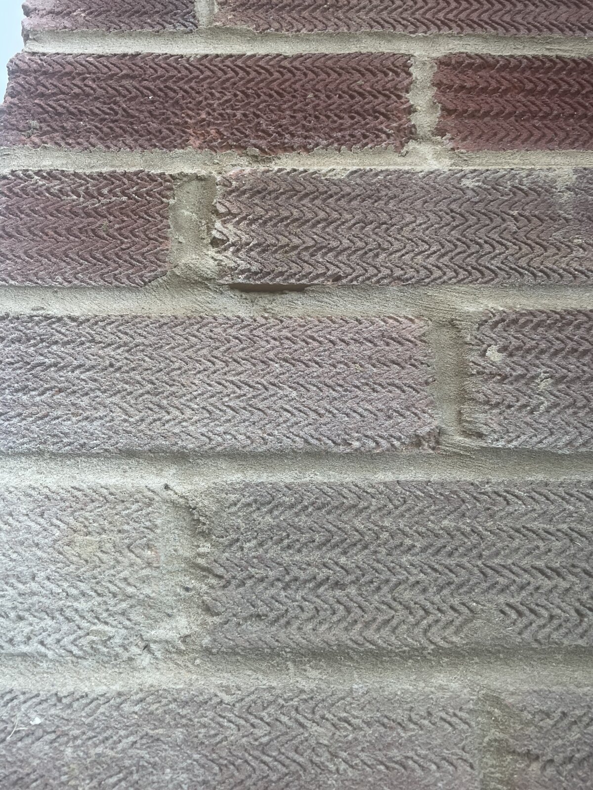

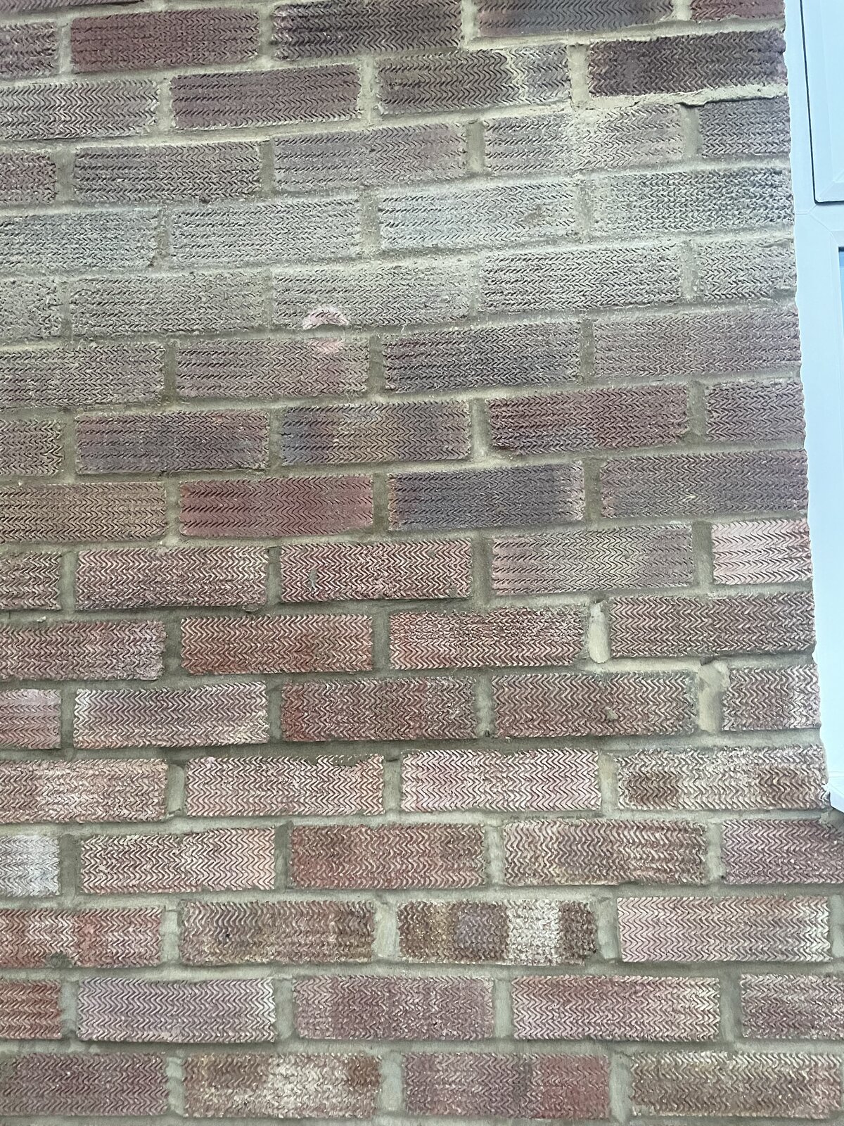

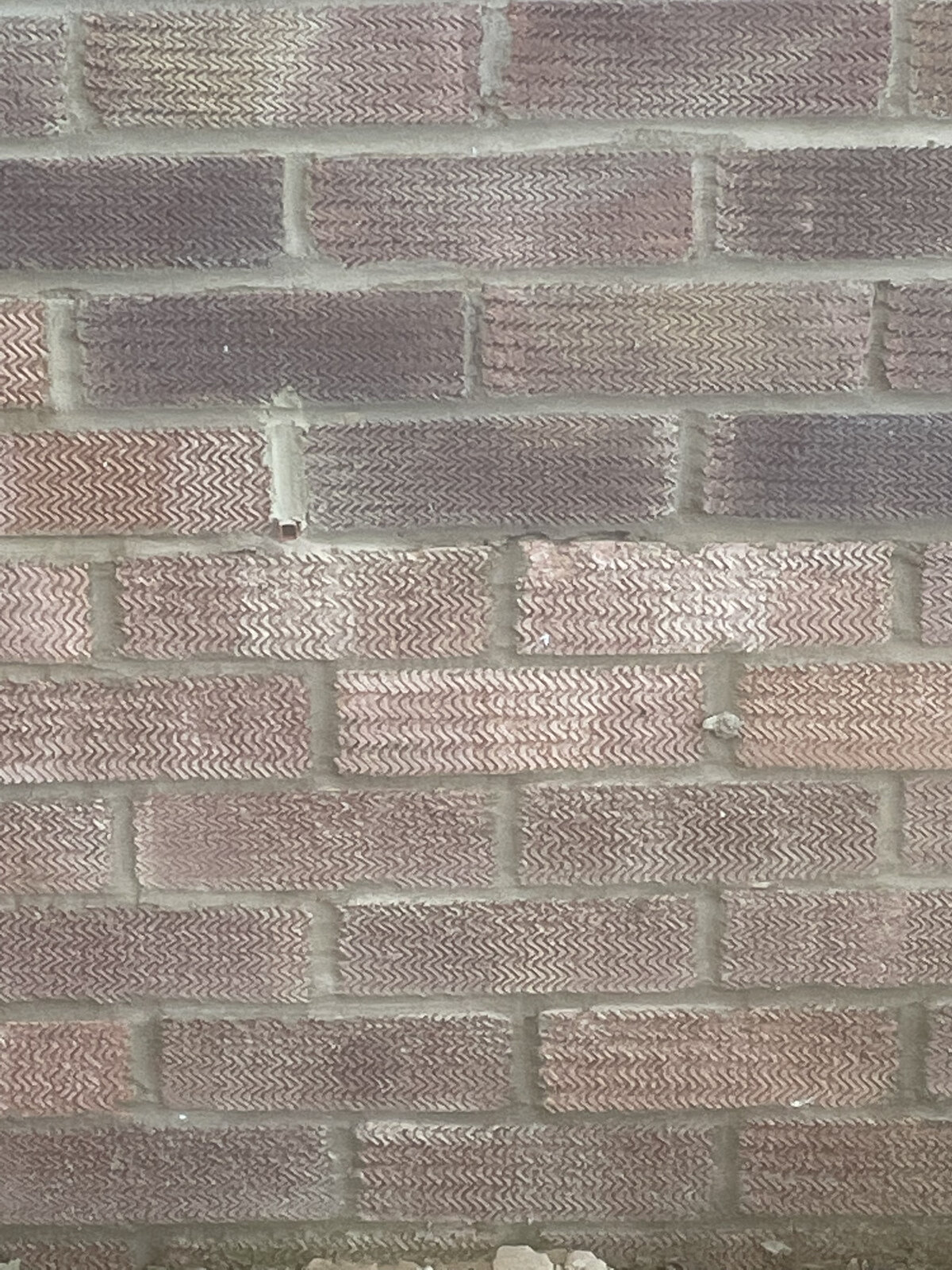

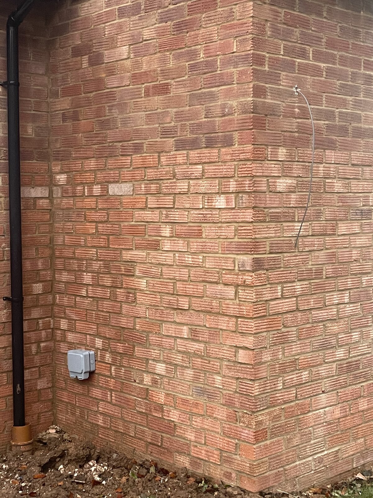

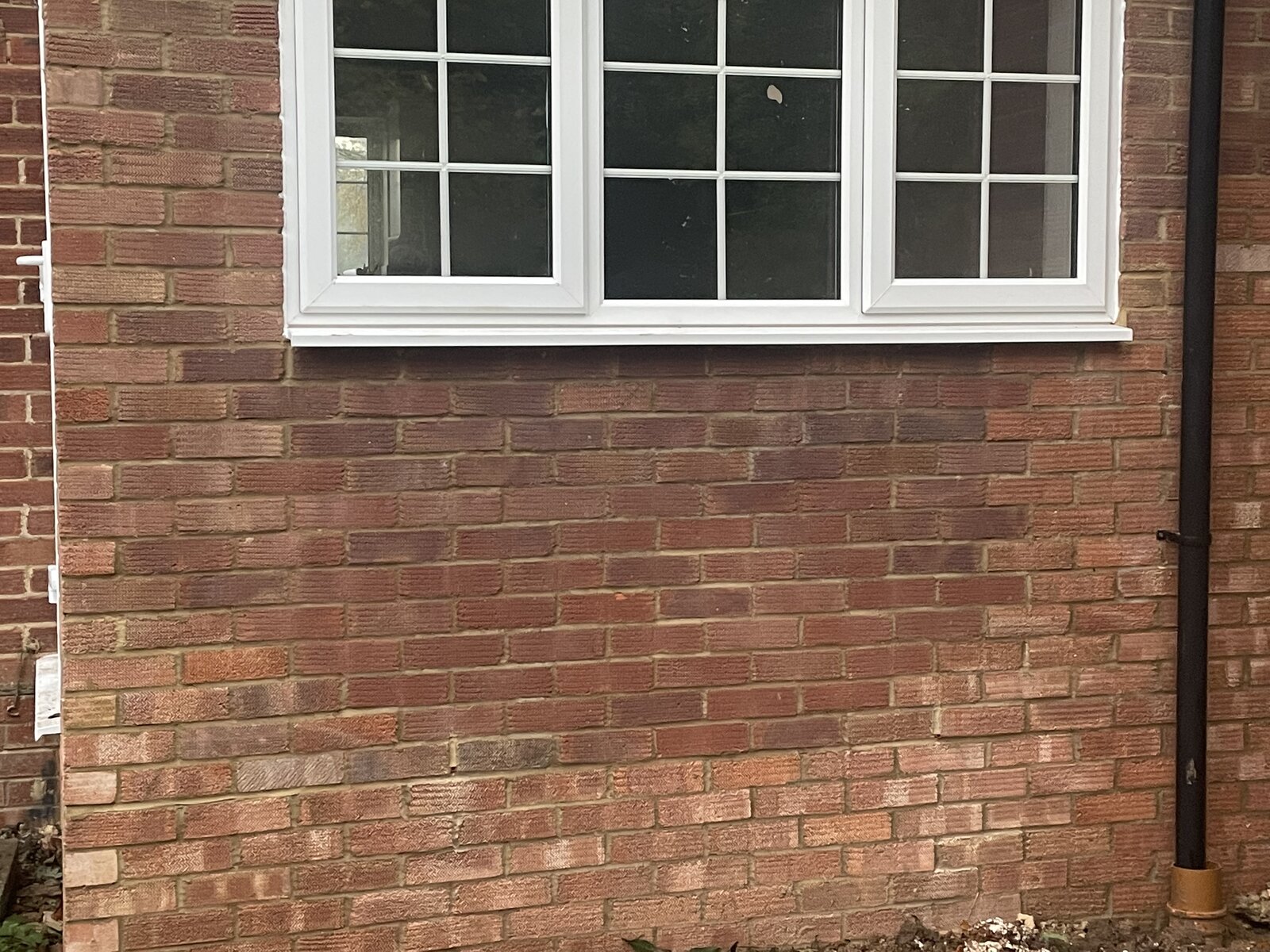

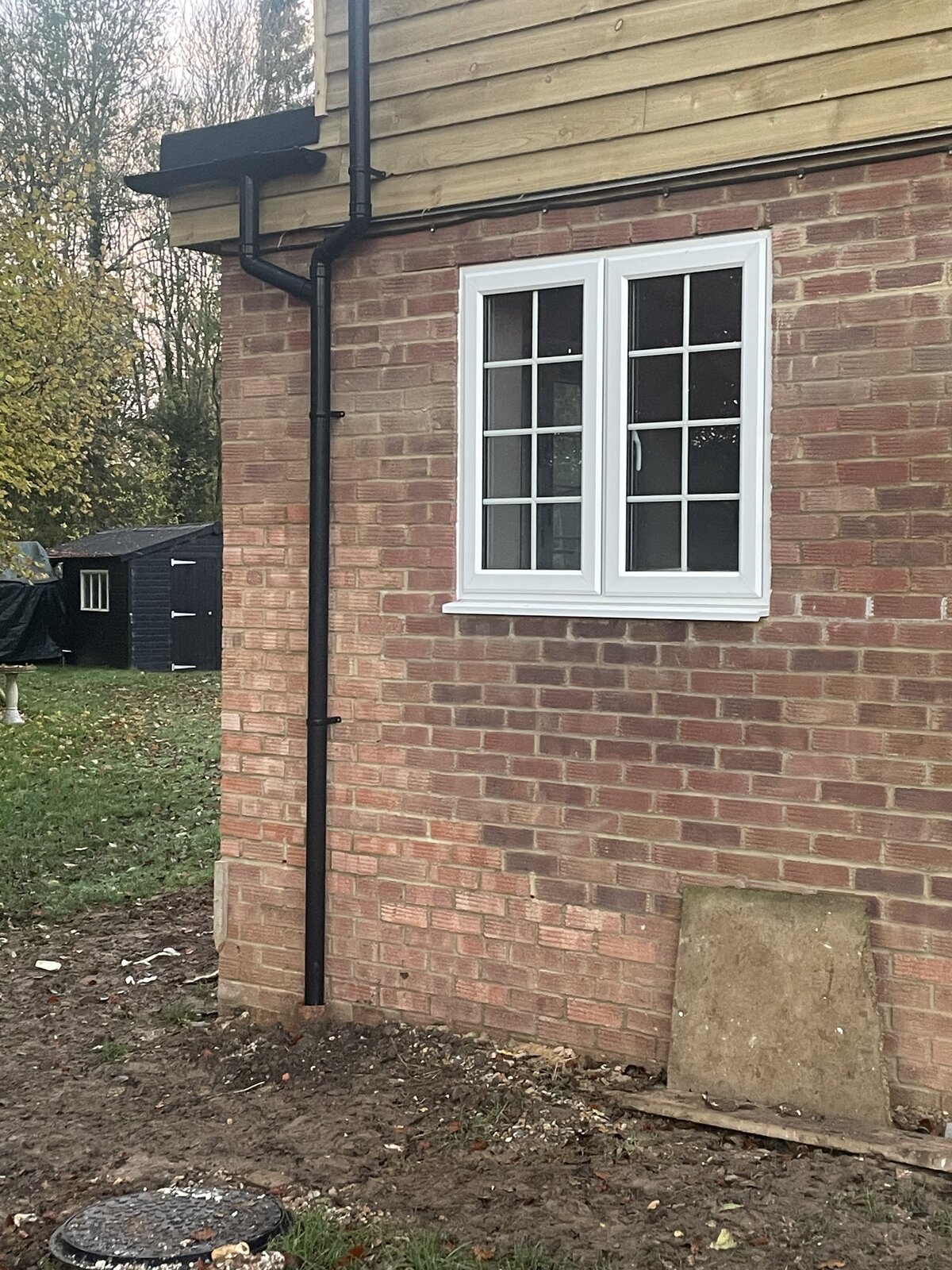

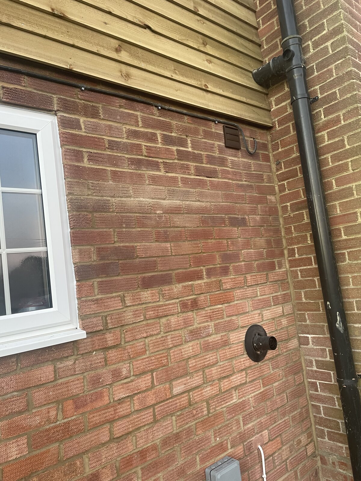

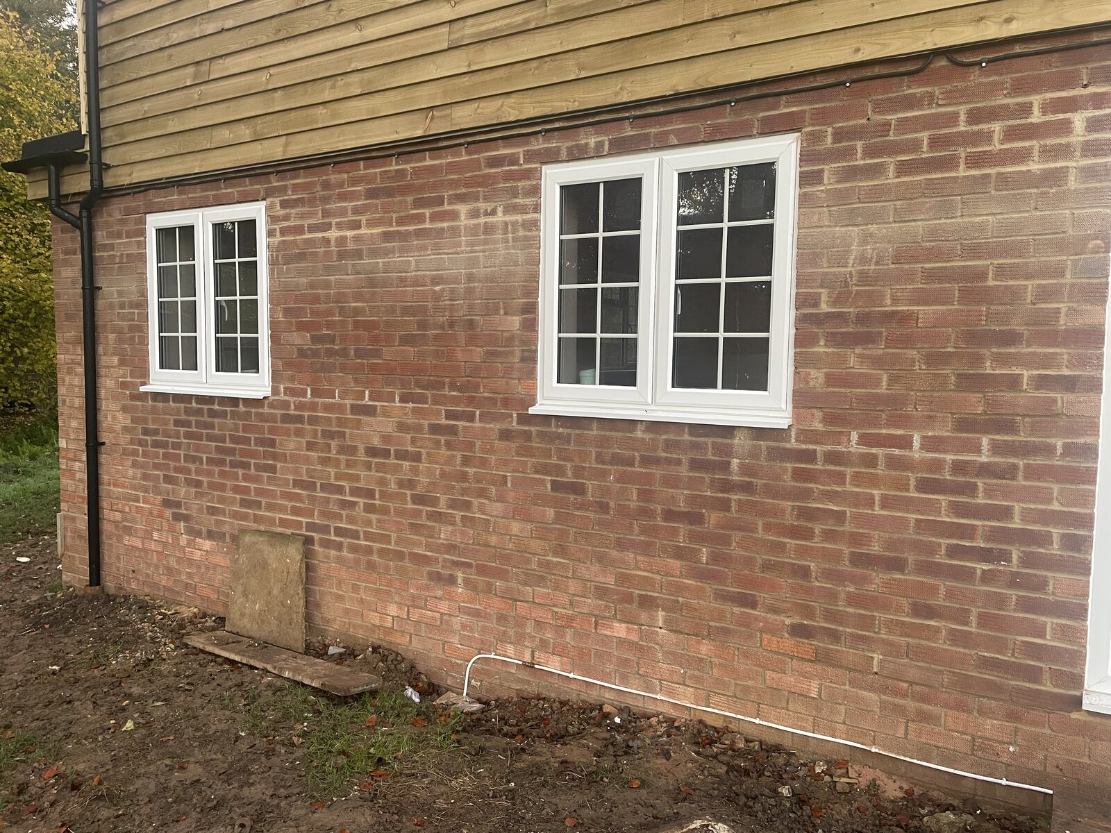

Hi everyone, a newbie here, just in the process of having an extension finished. Putting together a list of issues to be fixed. Aesthetically I’m not happy with the brickwork, have raised this but hit a blank wall! am I being unduly picky? I don’t mean to be . Abs I’m thinking of using a snagging company, hard to find as they mostly seem to do new builds, anyone used any body?

There’s two different colours of brick. I don’t understand. Is one the origon and the other used in the extension
No idea! We requested them all to match the original house, this is what we’ve ended up with….
So on the first photo there is about 22 courses of one colour of brick then it changes. Is the whole of that wall part of the extension. I mean is it all new.
2 different pallets.
They should've picked them from both pallets when erecting the extension.

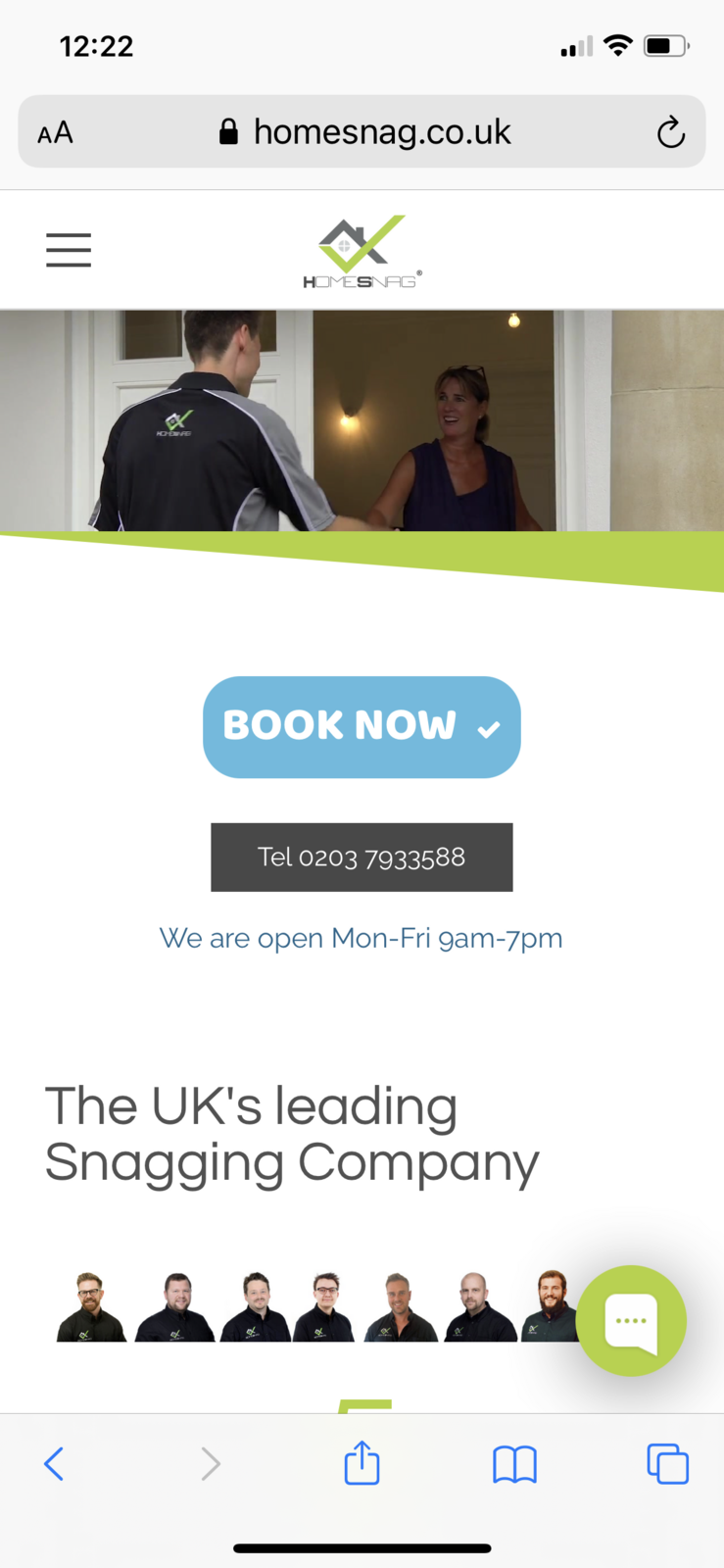

Did you call one of those snagging companies???
I never understood how they make money.
Hi, ah ok ref the pallets, will the bricks weather too be the same or is it something I should raise. I haven’t called those snagging companies, they only do new build, I’ve found a RICS surveyor who assesses extensions etc
To be honest some bricks are obviously quite a different colour. In my opinion thats more than a normal variation between pallets. What a shame. I wonder how nobody noticed as it was being built. Surely the brick layers would have noticed. I guess you can’t always match bricks between an extension and existing house but what you’re showing isn’t right at all. No they won’t weather in. I’d be really disappointed if it was me.

Difficult to see different shades in bricks when they're on pallets.
Like everything else that is the "face" of a project, different packs need mixing, same as for laminate, tiles, etc.

That looks like more than pallet variation. The lower half is orange/multi and the upper part is red/multi. I’ve never seen a newly built house wall look like that. Its complete nonsense. How on earth did your builder not notice lol. I think if whoever built that isn’t acknowledging the problem then whats to say they won’t do it again and as such I’d take whatever legal action is required if only to make sure somebody else doesn’t get a dodgy extension. If they admit the mistake and come to an agreement with you to compensate you in some way (it does devalue the house) then I’d just stop looking at it. Its kind of growing on me in a quirky way. Its origonal and a good talking point…. but I am not sure a buyer would see it like that if you came to sell the house.

Its unbelievable how the brick layers hadn’t noticed the orange bricks on one course and then the next ones being red. My guess is that they did notice and that the red coloured bricks are actually a different brick altogether rather than just a different pallet. Maybe ordered in error or order processed wrongly and then the cost of haulage to collect the wrong bricks back and deliver the correct ones was simply too expensive. Perhaps they believed that the colour was close enough and when they had built enough to see how different it looked on the walls it was too late to go back and undo the damage.
