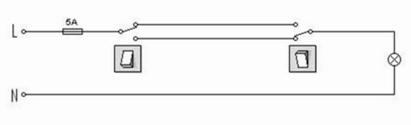

I also thought that, the link would normally not be in the com for two way switch, there are more than one way to wire two way switches, but normal way is com to com with no switch wires and then L1 to L1 and L2 to L2 either L1's are permanent line and L2's are switched line or vice versa, and where a line in borrowed from another switch that is clearly the permanent line.Did it ever work?
When did it stop?
Looking at the connections in your old switch, it can't work as two two-way switches.
The borrowing of the permanent line is not recommended as it can cause interference with hearing aids and can result in a borrowed neutral when up and downstairs is split. However nothing to say it's against any rules as long as no borrowed neutral.
This is the circuit diagram
