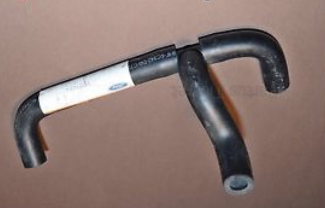

There is an incredibly difficult-to-get-to PCV pipe from the inlet manifold which is involved in controlling the idle. Apparently these are prone to splitting. I will check at the weekend if mine is split and if so, replace. Absolute ar*e of a job by the the looks of it involving removal of the manifold itself but I will see what I'm working with later.
I noticed yesterday that the throttle pedal has an electrical box and no cable so it is actually an electrically-controlled throttle so no idle control valve.
Very easy to do, I’ve changed quite a few in my time - they normally turn to mush and collapse in on themselves. You can sometimes hear them sucking air. Definitely don’t remove the manifold though. I use an extra long pair of long-nosed pliers like these (https://www.manomano.co.uk/long-nos...-fupV1simcFTBVjhZI5iSES_MFmLinPQaAn_9EALw_wcB) to remove and refit the hose from where it connects the engine and pcv by getting the pliers through the manifold. The hose should look like this:
Thanks -- that's the pipe and not had chance to look yet as partner needed the car for work while she awaits her lease car. I've only managed to find one guide online and in that the chap removed the manifold for access. When I get chance to have a good nose around I'll see how difficult to get to. I've had air intake pipes split before but they've usually been easy to get to.
