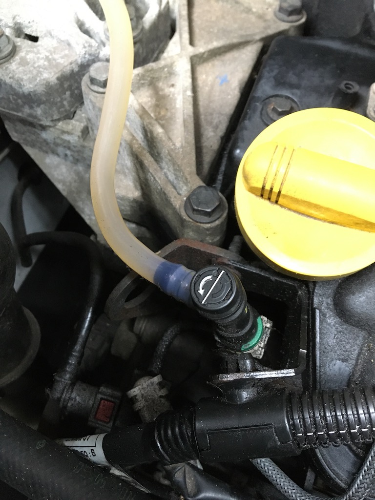

Need to resurrect this thread, as I've had the same issues over the last few days.
Problem is intermittent starting.
Key turns, there's some whirring, with foot on the brake pedal (semi automatic) you turn the key, there is a single click, but the engine won't turn, sometimes this will take 7 attempts sometimes less... occasionally first time.
New bit of info, spotted this morning, lots of air bubbles in the diesel line from the fuel filter to the engine.
The 'valve' connector (sorry don't know the term) is quite oily... could this be the source of the air bubbles?
Once successful turned over, running seems fine.
I read an old thread about a dodgy hand priming bellow being a culprit, mine looks ok, on initial glance.
Any thoughts before I call the cavalry?
TIA

I would not expect it to be the brake pedal, if you can hear the click when you turn the key. Does it click even if you don't press the pedal?
Back to basics - If it clicks, yet fails to crank, I would suspect either the starter motor or battery. Try turning the key with the lights on, do they dim appreciably? Not dimming even slightly suggest the starter motor. Dimming a lot suggests the battery or it's connections are poor.
Not dimming suggests the starter motor has a bad winding or duff segment. You need to replace it.
The loud click is the solenoid which does two things on a pre-engaged stater motor - it puts the bendix into engagement with the flywheel, then applies power to the motor windings, to make it spin and the flywheel along with it.
Air bubbles in the diesel might affect the starting and running, but they will have no effect on whether it cranks the engine over at all.
If it won't start via a jump start then fit a new starter motor.
