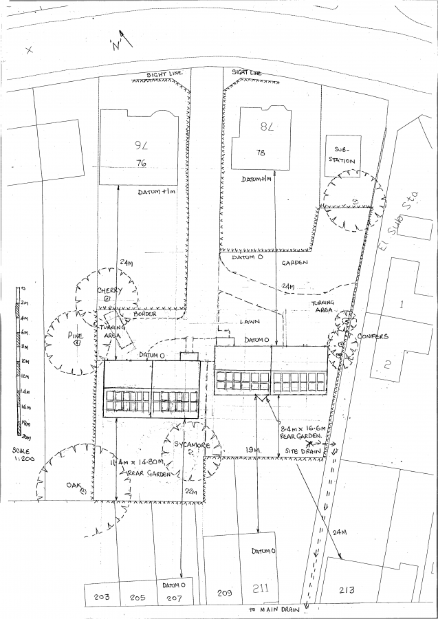

Thanks for the replies. I am more interested in the 13m between window of habitable room and a blank wall. Somebody has put in a planning application to build a 3 bed house with attached single story double garage in front of our house. We have four large windows at the front of our house (living room, dining room and 2 bedrooms) and they would face the end wall of the double garage, which will be higher than the ground floor windows. The wall would be about 6m from the front of our house.

The site plan is below. Two new three bedroom houses with attached single story double garages in the centre. Our house is number 2 on the right. There is a footpath with low fences either side between our house and the development.
most councils would initially apply the 45/25 degree rule and anything falling within that area would require further assessment as to any deprivation of light.
Many councils have policy on against back land development like this which may be a better case of argument against the development if it exists.
Another argument could be against the road entrance on the corner. A "sight line" should be calculated based on distance you need to see up the road which is based on the road speed limit - its not currently clear if this has been properly worked out. Also the turning areas look insufficient.
Likewise the trees don't look very considered - has a tree impact assessment been done to show root protection areas. They might not be important but some of them are in other peoples gardens so they will struggle to get removed.
That's a pretty good assessment! It was refused for four reasons:
1. Not in keeping with surrounding area.
2. Too close our house and houses to the south, causing loss of privacy and light.
3. Damage to root protection zones of neighbours trees.
4. Insufficient sight lines on access road.
