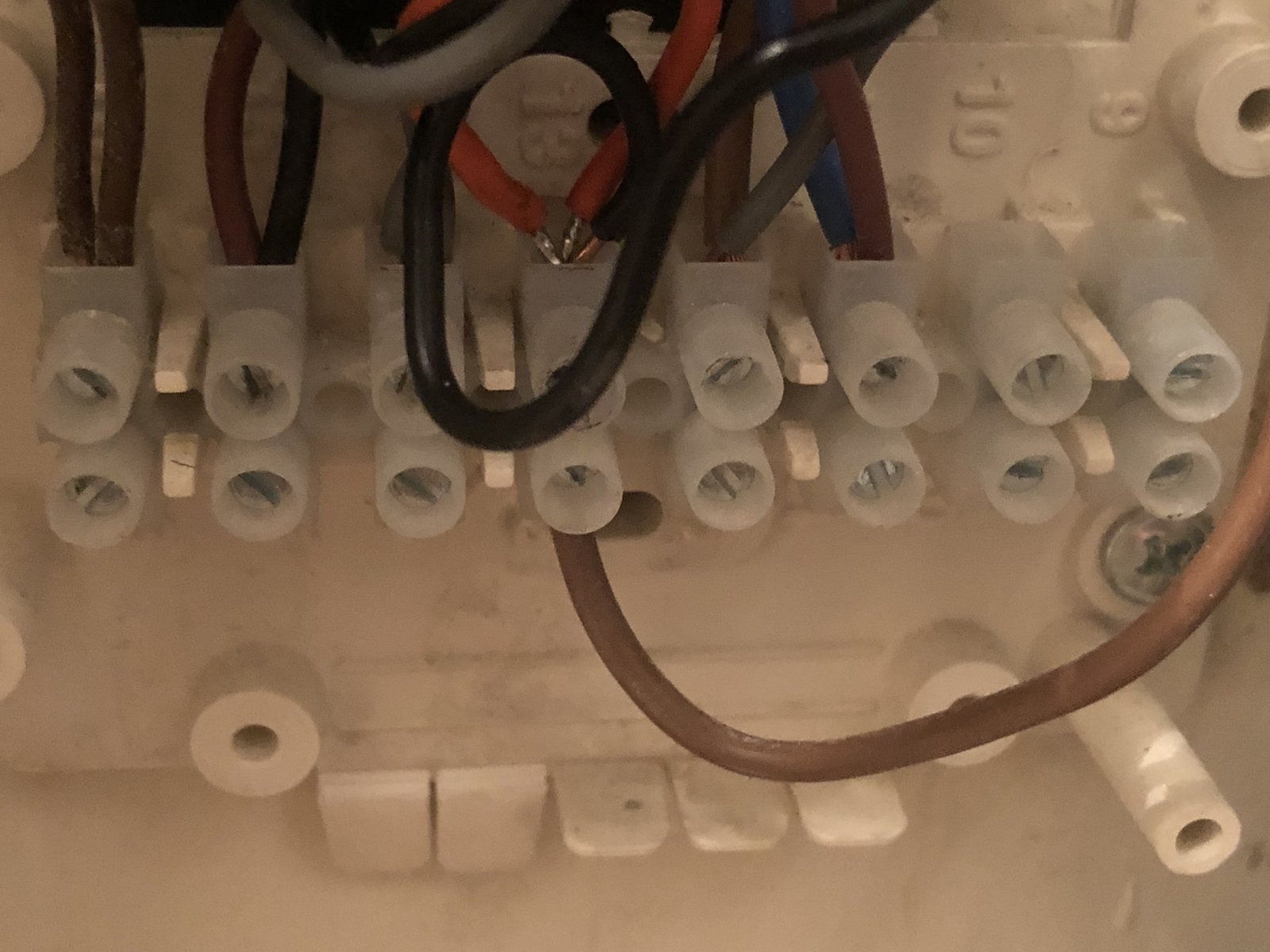

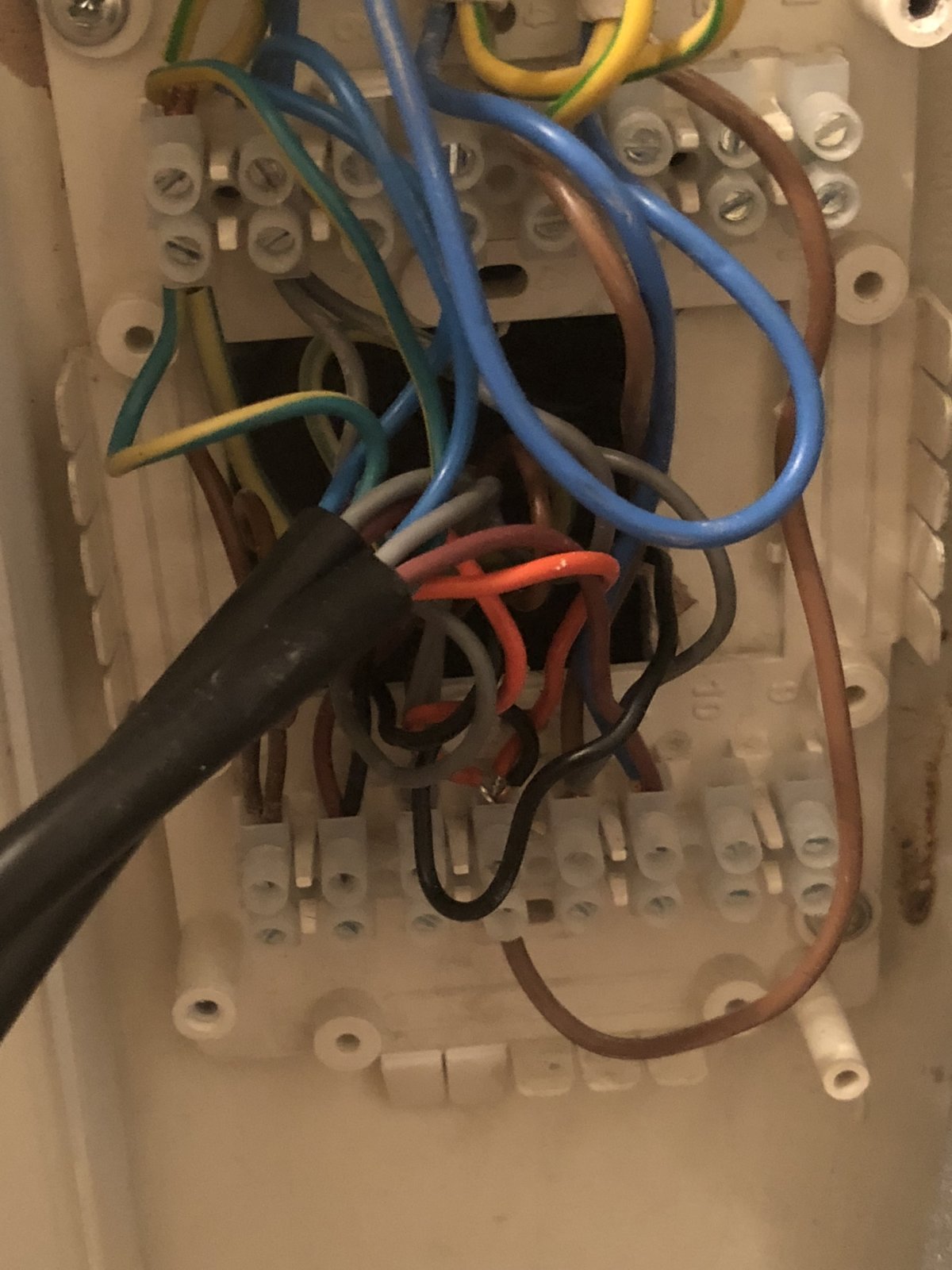

Good morning all

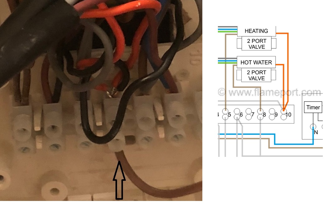

I’ve taken pics of spaghetti junction:
Too many connections on the Switched Live to the boiler
Either the Brown or the Black goes to the Switched Live on the boiler. But where does the other one go to ?
