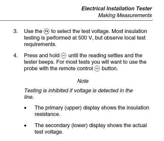

Fluke is the same, the button is held and you can see the value changing, such as on long circuits where the value will increase over a few seconds due to the capacitance of the cable.
Fluke instructions: ... Same process applies for continuity - holding the button is essential.
Yes, I obviously realise that (otherwise I would never have been able to use the machine!). However, my point was that, AFAIAA, (nearly always following a very rapid 'settling' process, during which time figures usually can't be read) once the machine has 'beeped' the display reading is locked, even if one continues to hold the button pressed beyond that point in time - so (again, AFAIAA) any subsequent changes in IR are not seen unless one presses the button and starts the process again. However, I've yet to 'do the experiment' - so watch this space!
