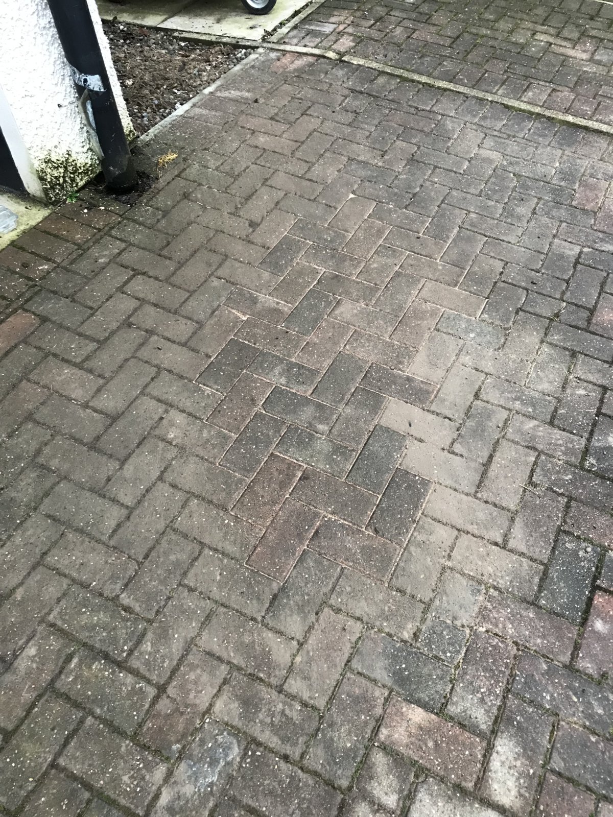

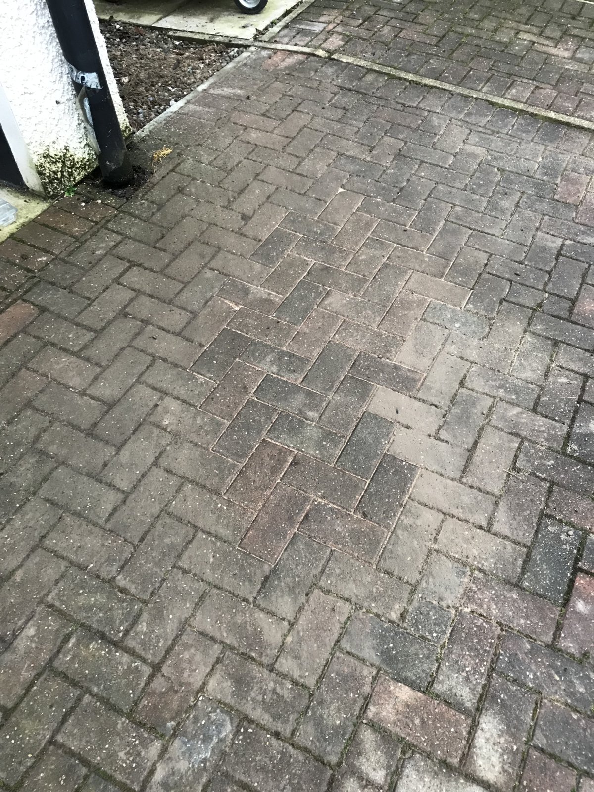

I thought that so dug at the meter and capped off and it stopped. I dug at 20mtrs and it stopped. Then I overlanded the last 20mtrs and it stopped.
So i’ve narrowed it down to 20mtrs but can’t pin point it. Very strange.
Possibly but usually it would open up the hole
I was thinking that something has pierced pipe from outside and the extra air pressure pushes that protrusion, that's coming into the pipe, back out, thus sealing it... it is only a thought :)
You might be right (y)
I’m back tomorow to do some more digging at 10mtrs, 5mtrs, 2.5mtrs... :(
I could but we hire the mole kit in but can’t get one tomorow. We should be able to do 4 digs in the day.
