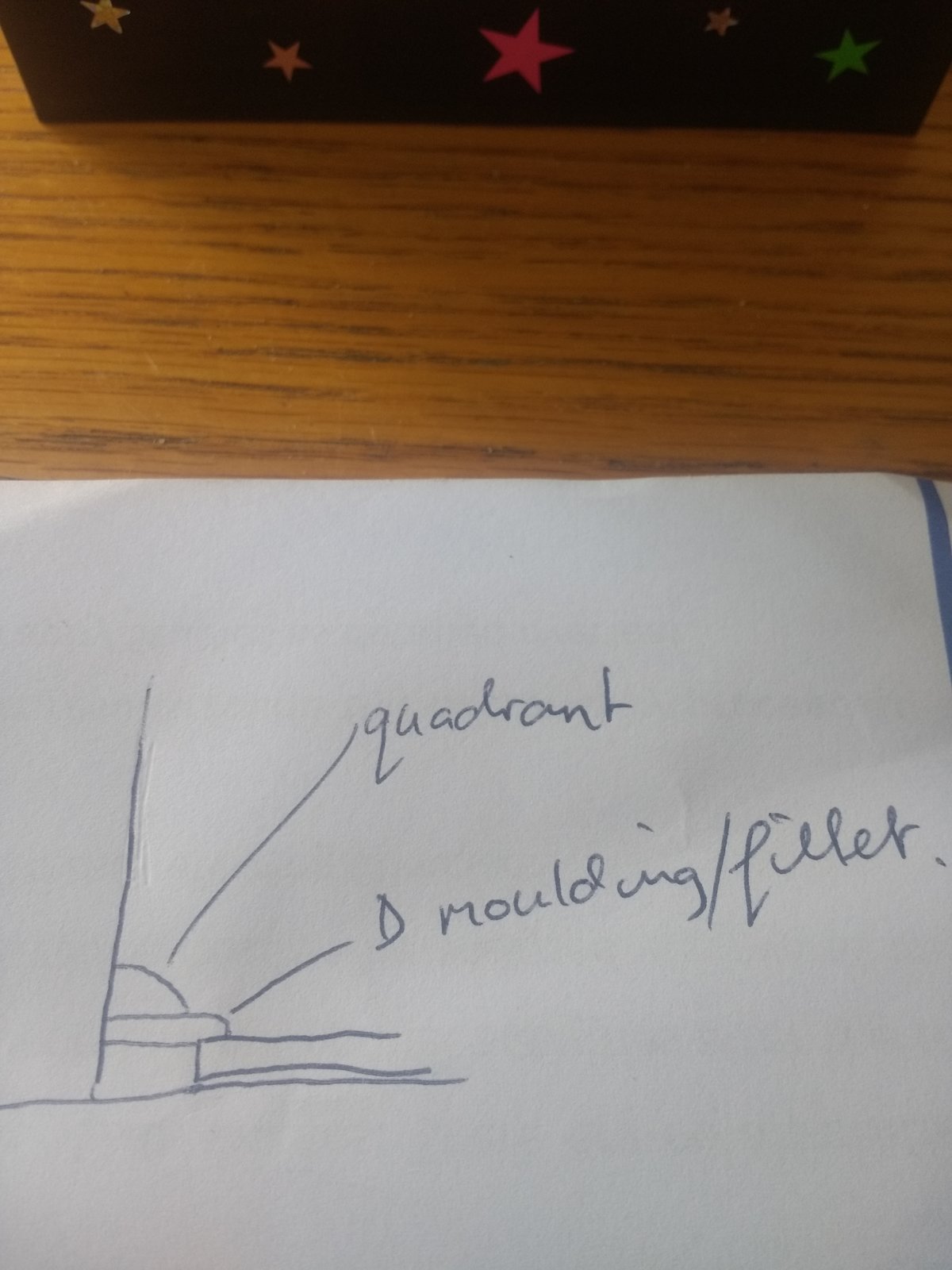

I’ve got a gap between laminate flooring and upvc patio doors, about 25mm. I’ve searched but unable to find plastic quadrant beads more than about 18mm. Guess I could use a wooden one, in which case any ideas how best to fix it to the upvc? Silicone? Small nails? Gripfill?
Anyone know of where I could get a plastic jobby or tips on fixing a wood one? Cheers

I would be thinking about something like this:
You could screw through the bottom of the fillet into the quadrant with small self tappers or woodscrews.
Regarding fixing to the doors I would ask on the windows section, it's something they do all day long (and they may know even better tricks).
Buy the stuff from Eurocell - wear your old clothes and you'll get trade price!
Just go for a white plastic flat bead/trim if the windows are white. Fill in the gap with a redundant piece of laminate.
