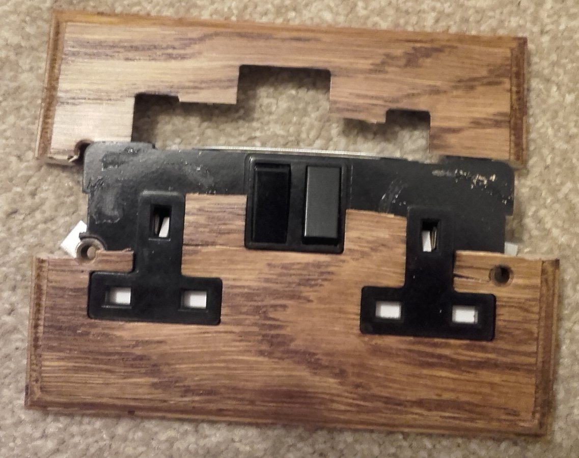

Hi folks,
I have a classic 2gang 13-amp switched socket in solid oak and I'm trying to remove the metal back plate from the oak case. I want to paint the case and it would be easier to do it this way instead of masking of the switches and sockets. Any ideas how this is done? I've removed the three main screws, but there are two pivoting metal strips which slide into the wooden case which I'm struggling with.
Any help would be appreciated
Thanks in advance

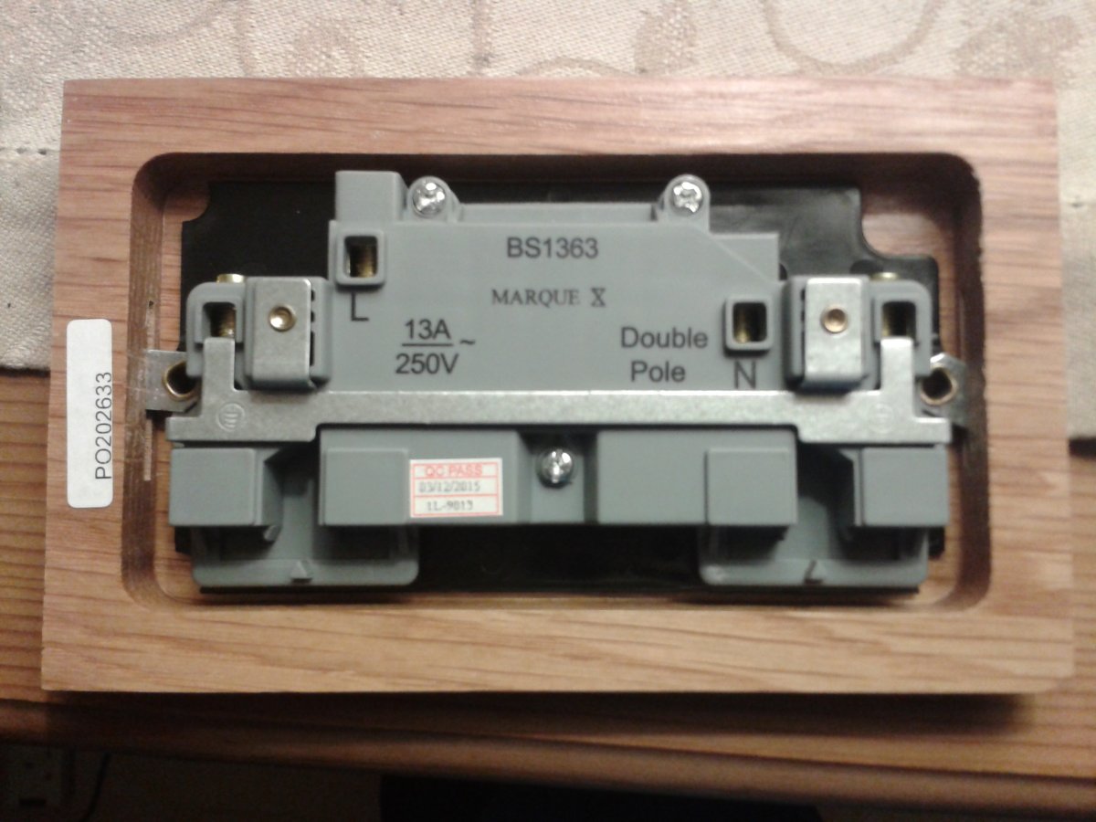

Surely the 3 screws referred to have already been removed and secured the plastic to the wooden part - not the 3 still in place which hold the socket together?
I have just 'opened' a faulty one of these. They do not come apart as the brass screw hole rivets hold the wood to the back, even with the metal tabs rotated out of the way.

Looks as if the wood was glued to the black plastic, as well as held in by those rotating strips of metal.

The metal strips rotate but there's not enough clearance from the metal plate for them to rotate enough to come free. Plus as mentioned above, I suspect they may have been glued as well as they do seem rather solid. And the rivets are the final issue which I think makes all the elements pretty much inseparable.
